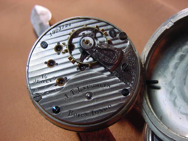

Heres the movement, I believe it is Illinois

April 24, 2009, 18:58
Bill
Your watch is an Illinois, grade 69, model 6, made in 1906.
Your jeweler appears to be James T. Laughlin, born in Ohio in about 1864, in 1920 he is living in Boise & married to Evelyn S., he is listed as a retail jeweler.

April 24, 2009, 21:35
Bill
I would lean towards a replacement, I would think it would have had the jewelers name on it. For a Illinois of that date it would have been either single or double sunk enamel & marked Illinois Watch Co.
