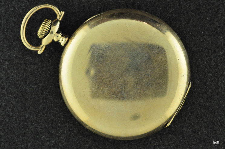

I would think that a tall pendant, goldfilled , maybe keystone case would do , going by the examples for sale , what does your case look like Thomas ?
December 02, 2018, 10:15
Claude Griffith
The one Kevin pictured would be time period correct, the super tall pendant were in the later 1800's, this style is from the later 1800's to early 1900's then around 1910 or so you started seeing the shorter pendants and around the 1920's or so you see the no pendant types. Any brand gold plate or gold filled with a fancy bow would dress a 960 up nicely.
