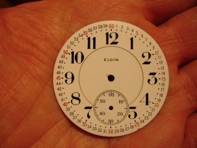

I have a damaged Double sunk Montgomery dial.
The pictures do not show the cracks but there is a significant one from around the 5 up to the 1 position. I am fearfull that a piece of porcelain might come off so my idea is to use some UV clear adhesive along the crack, allowing it to soak right in, wipe away the surplus and then place in sunlight to harden off.
What do people think of this idea?.

Stephen,
I don't think it's necessary since the enamel, even though cracked, is fused to the copper base and not likely to flake off. The only times I have ever seen lost enamel is when the the copper has been deformed from behind. I would just clean it up and don't worry about losing anything.
William
info@whitescrystals.com
April 14, 2011, 02:53
Hello Stephen,
I agree with William completely and I too would urge you to not introduce any form of adhesive or sealer. Those slight "cracks" or "hairlines you see were caused by forcing the dial when it was removed or over-tightening when re-installing. Remember these watches were serviced every few years during daily use and all it takes is one misstep in the process.
This dial should be carefully cleaned much as you would hand-wash fine china, use of a soft-bristle tooth-brush is often helpful. If you like, the little chips can be filled-in with white porcelain-enamel touch-up or ladies nail polish of the exact shade. After twenty-four hours minimum drying time "shave" off the excess with a single-edged razor blade.
April 14, 2011, 11:25
Claude Griffith

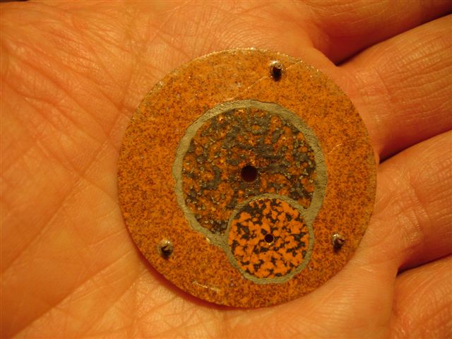

Here is an A.N. Anderson dial, as you can see it looked extremely bad, some spots the chips were missing. I cleaned it by using a soft bristle toothbrush and joy, rinse it and soaked it in a solution of bleach and water or you can use polident with water. I filled the missing chips with white acrylic titanium paint (for artists) and yes if you look closely you can see the repairs and if you get a magnifier you can see where the hairline cracks but it looks a heck of a lot better. I would not spray anything on it, the dial itself would look great with just a typical dial cleaning.
