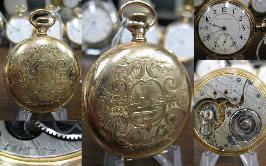

So I was wandering around eBay, and this Illinois Getty pops up. I am a sucker for "orphaned Getty's" even like this so I win it for $39.00.

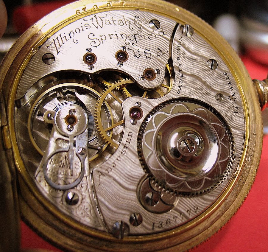

David AbbeThe seller listed it as s/n 1867779,
BUT it is really 1367779, and missing a roller jewel pin, but altogether OK. So I put in another roller Jewel pin, and it runs. I dig out a Hunter case and instell it in that with a replacement second hand and start researching the serial number . . . The blue bible rates it as a Grade 175, BUT Ehrhardt's last 1996(?) edition calls it a 177!
. I look at the descriptions and the movement more carefully and it looks more like a 176. Anybody? (btw, tomorrow this is my "homework cleanup and make pretty project

Eric UnseltLove that case, Dave - anything with engraved scenery.

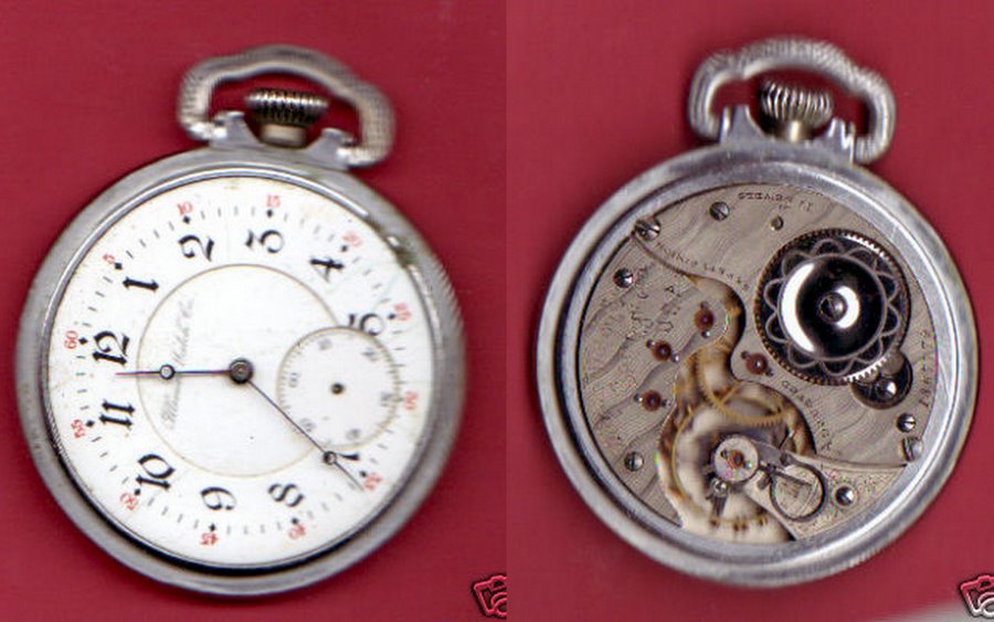

Mike SandellDavid nice Illinois getty you did good work on it here is the only one I own.

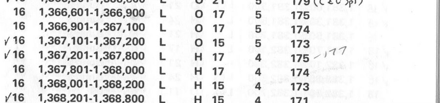

David, Beautiful watch. All I could figure out is that it's a model 5 (form the list) and please tell me how you know it's a 175,176 or a 177. The book doesn't mention anything about it other than showing that some are that number with no reference.

David AbbeSheila, To answer your question, when you look up this serial number in Meggers/Ehrhardt, you see this . . .

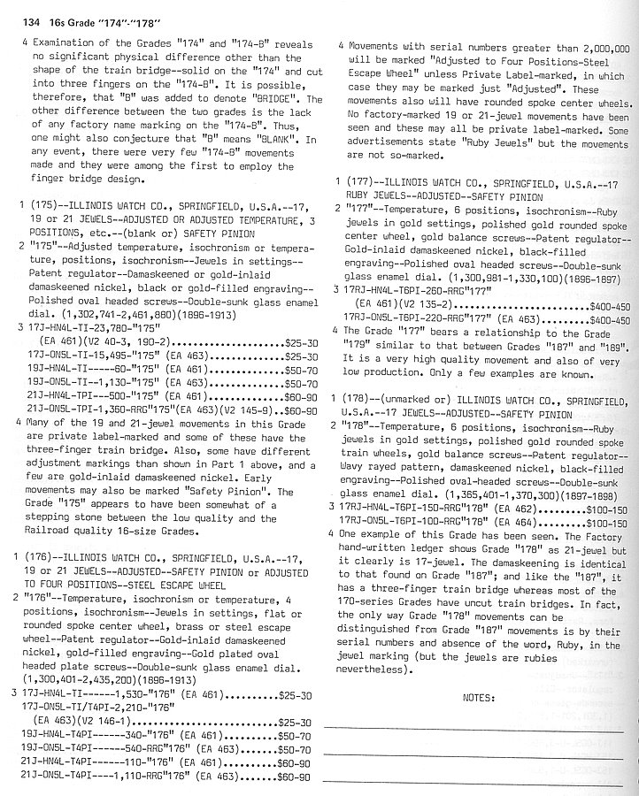

David Abbe. . . then you go to the page describing the movement of that listed grade and this is the whole page. (I must add that after careful study, I think this is an early Grade 175.)
