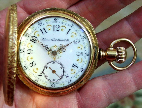

I think I have accepted this situation but I still can't explain it....
At the L.A. Regional, I bought 3 beautiful Elgins, with fancy dials. The cases are all lovely; one is 14k and two are YGF.
The most spectacular case is a J.Boss, hunter, very thick and with a flat, highly engraved body. It is quite heavy but it is definitely a gold-filled case. It is clearly maked "Warranted 20 yrs) and it has original case-papers that match the case numbers and identify it as gold-filled.
So.... today, I began my service and general clean-up of it. When I removed the movement, I was surprised to find, inside the case body, a band of very shiny gold, marked "J.A.S. Boss 14K."
This looks like gold and has gold markings that are as elaborate as any I've seen. It also accounts for the heavy-weight of the case body.
I am told that this is, indeed, a band of solid 14k gold. The explanation that I was given was that it was meant to prevent metal interaction (or somesuch) in the thick, thick case.
I'm convinced that this is indeed a solid gold band inside a gold-filled case but I'm still not sure as to why. Has anyone seen this or know any explanation?

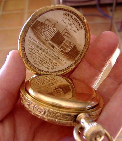

This photo shows the thick case and the watch-papers that identify it as gold-filled.

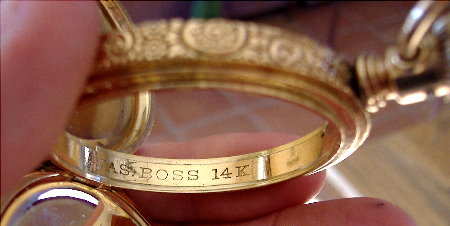

This is the band of 14k gold, inside the case body.

I have seen this insert in cases... may have one marked 10K also....... but don't remember which watch it is on right now...
how did u test for solid gold.....?
I thought perhaps these were a dust ring....
had a discussion once with an ebay seller offering an empty case and they said the case was solid gold because of that marking..... Wink
not knocking the case or anything...just ....wanna learn .........
February 23, 2006, 19:49
I have some cases like that Peter.
John Duvall and I researched this some time ago and found those are apparently spacers. They were evidently intended to accomodate the differences in movements for a better fit.
Whether or not the spacer rings are gold or gold-filled we did not attempt to determine.
February 23, 2006, 20:08
Peter S. Balkan
I didn't test the ring for gold and I probably won't. To me... it makes absolutely no difference. There are some very fancy gold-filled cases that, in mint condition, are worth as much as a solid gold one... at least to collectors.
But... the marking is so elaborate. It is not just a 14k stamp. And... after identifying their case as gold-filled, with case papers and with the 20 yr Warranty..... why mark the spacer at all, except if it is different (solid gold)?
This is obviously a high-end case. It sounds crazy but I wonder if they put that spacer in there just to add heft to the case.
February 23, 2006, 20:20
Charles R. Sides
I have a case with this band also. Kind of shocking at first.
JBoss patented the gold filled process and I am quite sure they never made a solid gold case. I would like to hear from anyone that has a solid gold JBoss marked case.
I convinced myself that it was a gold filled band. Have not had it tested.
February 23, 2006, 21:29
Well, I opened one of mine. Turns out there is a file mark on the spacer which has markings identical to the one in Peter's case. But get this, the file mark is deep brown color from when it was evidently tested however many years ago by a skeptic. That of course means the core is indeed brass making the spacer ring gold-filled.
That follows logic if you think about it. After all, the "Jas. Boss" patent was for gold-filled cases. At the time these were made everyone involved in the jewelry trade knew that fact. So the name "Jas. Boss" followed by "14K" would be like expressing "14K Gold-Filled" and would not have been confusing at that time.
Great topic Peter, another "something new" we learned this day!
February 23, 2006, 22:14
Peter S. Balkan
OK... I'm beginning to be convinced that it's gold-filled!
It doesn't matter to me.... it's not going to the smelter in any case. Gold or gold-filled, it's very interesting and another indication of a high-quality case.

Peter - is this a hunting case? I have often seen this ring used for a dual purpose on a hunting case:
1) to help hold the lift and catch springs in place
2) as a dust ring to protect the movement from dust coming in where the lift and catch springs come through the bezel
February 24, 2006, 01:14
Peter S. Balkan
Yes.... it's a hunter! I ought to have it serviced and recased tomorrow. New looking, Elgin, 15J gilded movement. Perfect plates, not a single cracked jewel. Fancy dial, not a hairline. Ornate gold hands.
16sz too, 1906.
I'm a sucker for this stuff! Smile

nice looking dial there....
the examples I have seen have been open face..

Well.... I have a VERDICT.... but first....
It didn't matter to me if the ring was solid gold or gold-filled. I was keeping it anyway. But... it nagged at me. So... today, we pried the ring up just a tad. It's friction set and tight. We got just enough of it above the case so that we could apply a stone to it for testing.
VERDICT= GOLD FILLED!
February 24, 2006, 20:28
That agrees with the file mark on my ring.
Those spacer rings are gold-filled.
"And the beat goes on..."
Big Grin

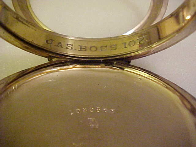

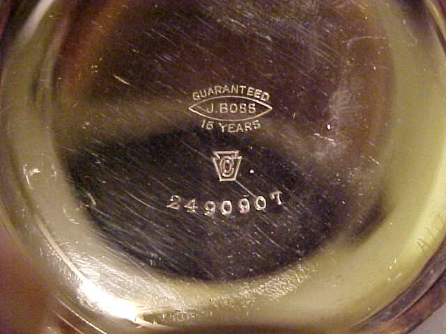

here is one i dug out here....
February 24, 2006, 22:01
Terry Hill

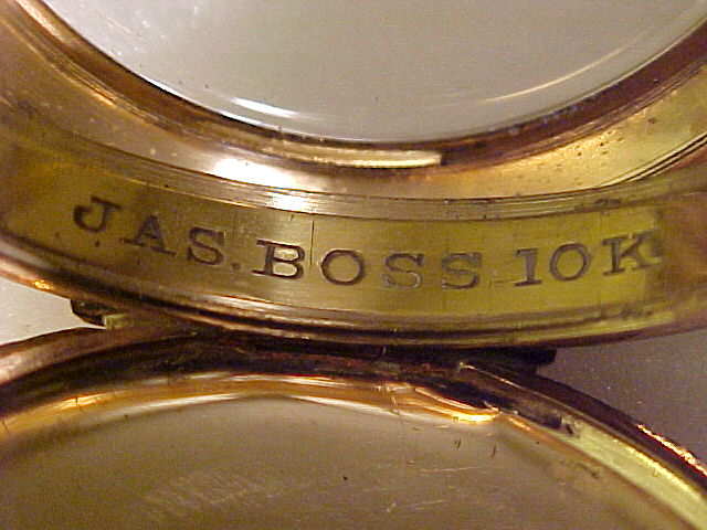

case mark inside curvette

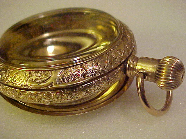

Terry Hill
it is a triple hinge open face...

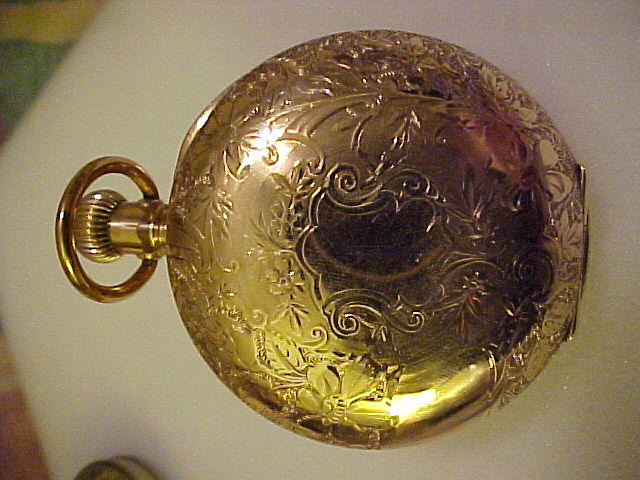

Terry Hill
decently engraved.... darn plastic crystal...

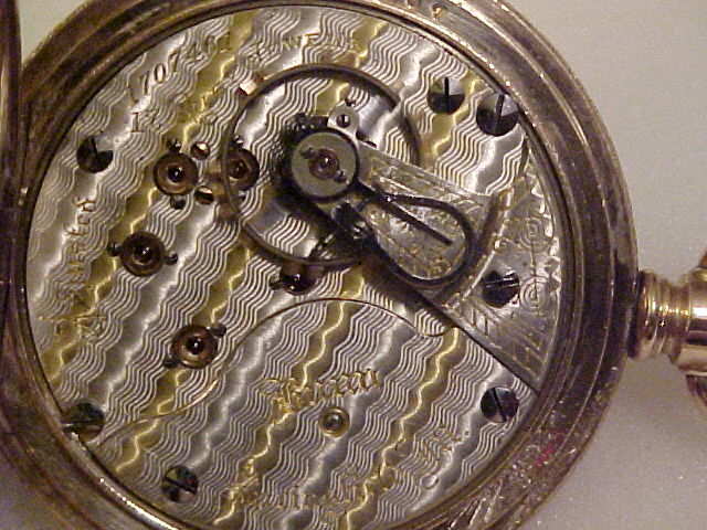

17j bunn movement fits tight though...

Terry Hill
another view of the mark...

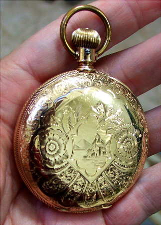

Hi Sheila:
The 14k case is a Keystone... well marked. It has a bit of wear but it's still pretty sharp. As the photos show, it opens to a tab more than 90 degrees and I noticed that the front cover hinge is just a bit loose.... not enough to warrant a repair. It's 16sz.
The bow is obviously not original. It's gold-filled and worn. I've located an NOS replacement but it too is GF.
I used to have a rule that I would buy just about any 16sz gold hunter for $500 and have recently raised that to $600. When gold starts to rise in price, our cases die in the smelter. Even gold-filled cases can be as much as 30% gold. A fancy YGF hunter case in mint condition, these days, is worth as much or more as a worn 14K.
That watch is now sitting at the shop, on the movement holder, running pretty well.... after a bit of a struggle. The movement's condition mirrors the wear that I saw on the case and someone had been "in" the movement as evidenced by a boogered-up hairspring and new regulator pins. I put it right but it took awhile. Elgin 15Jewels, gilded 3/4 plate.
Here's the back cover:

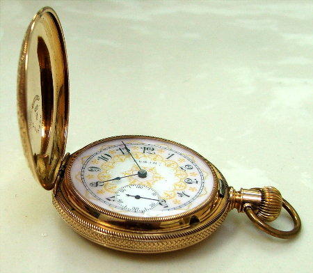

Peter S. Balkan
Front Cover open:

Terry Hill
one of the old 'rules of thumb' for keystone cases was if it had the scales marking, it was a twenty year case, and if the scales have a crown over them, a twenty-five year case...
now here yours has scales
mine has scales
yours not marked ( but has 14k mark on ring)
mine marked 15 year and has 10k mark on ring
Peter's is marked 14k on ring, case paper says 20 year.. ( peter, does yours have scales marking?)
Charlie... your markings?
i still think integeral dust ring.... jmho... and have been wrong as hedoubletoothpicks...
hmmmmmmmmmmm Smile

Peter S. Balkan
Terry:
1. Back cover (under case papers)= Scales with crown.
2. Cuvette = "Guaranteed, J. Boss 14k, 20 years"
3. Front cover = Scales with crown.
You have the photo of the case papers.

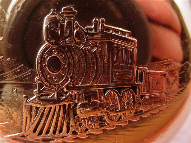

Charles R. Sides
terry
My inside ring is marked JAS. BOSS 14K
Cuvette is marked keystone with Co inside serial #2066163.
back lid marked crown over scales same serial #
It is my favorite case with inlaid gold train. This is from my days of GIANT pictures.
