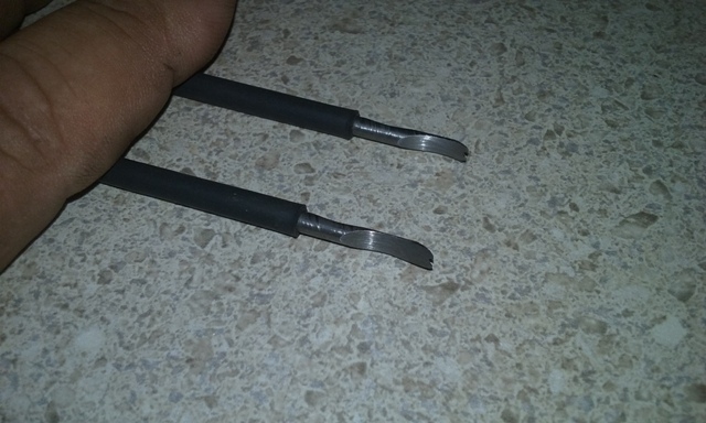

I have been fooling around with making a few Home Made tools.
At first I tried using broken main spring with a peg wood handle. Not being to terribly impressed I have now started using 1/8 inch steel rod ground down with my Ken Onion tool (knife sharpener). Here is a picture of a couple of levers I completed last night.
Any suggestions on improvement would be most welcome. Also pictures of any Home Made tools that I might might want to try and construct.
Thanks To all!

Look well done to me, for removing hands? One item that can be handy is a tool to hold the lever in place when reassembling full plate movements.

I used them Gary today to help a hairspring Colet along and off the staff. I find no end to the things I can use something (in the past a screwdriver) to help remove.

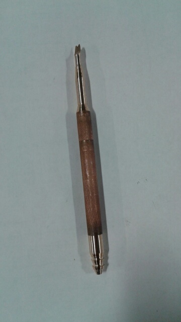

Looks good Kevin I made one as well hairspring collet remover out of brass.
