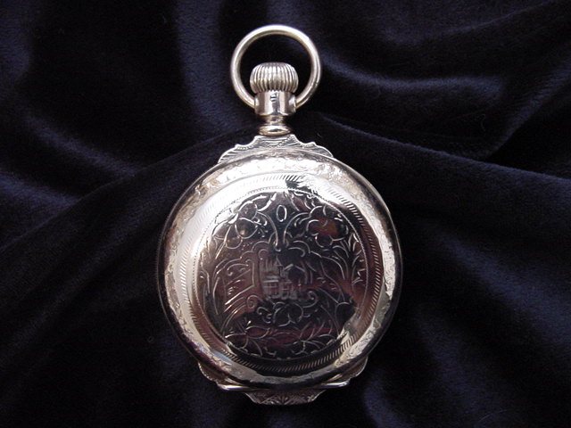

I recently picked up a very nice box hinge case and would like to pick your brains as to what movement to put into it (a Hamilton 925 or Illinois convertable). Was there any rhyme or reason as to what type of movements people placed into these nice cases. Just curious
I had to attach a pic also .. This is my first Hunter case for a watch other than a 0 size..

Terry Hillit would be best if you could determine the make of movement that was in the case before......
the 'fingerprint' left by the previous case screw marks... (if only one set).....
The screw retention on the stem indicates a early case, imho..... before "about" 1905 or so..... jmho....

R. J. LuckeI agree with Terry, make sure the case screws align with any marks in the case.

Sheila GilbertBruce,
I don't know a thing about movements, but I sure know that you have ONE BEAUTIFUL CASE there. I love the details. Nice buy!

Sheila's right, it sure is a beauty...But first, listen to Terry and Rhett, that's sound advice. This one should if at all possible house the same make that originally came in it. Consider also the era the case is from when choosing an appropriate movement.
Could we see the case-screw marks?

Bruce ByrdThe lower case screw mark is not present. There are two upper marks at about the 10 and 11 area.
