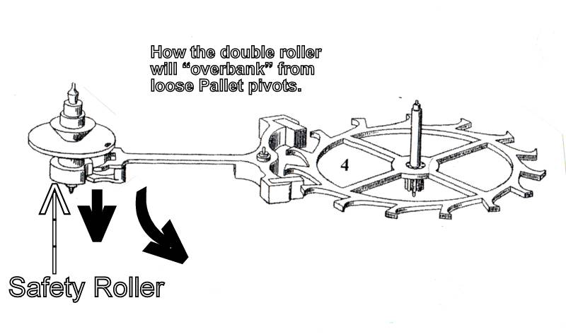

A friend came to the shop and showed me his nice recently serviced Hamilton double roller 992 with one "problem", it OVERBANKS!!!!
Double rollers are designed to prevent overbanking . . . all the time!
Here is a typical D.R. Movement;
July 31, 2013, 13:22
After a careful check, I found the problem. The Pallet fork bridge had not fully seated down to the dial plate. This allowed the very short pivoted (21+ jewel stuff only) pallet fork pivots to "fall out" of their pivots far enough that the pallet fork (as I discovered) was actually flopping up and down enough in the pivot jewels to let the safety pin MISS THE SAFETY ROLLER COMPLETELY!
INSTANT OVERBANK!
This is easy to fix (carefully). Remove the Balance wheel and Balance cock assembly, let down the mainspring and re-seat the pallet fork bridge to the dial plate making sure it leaves only a small end-play for the pallet fork.
