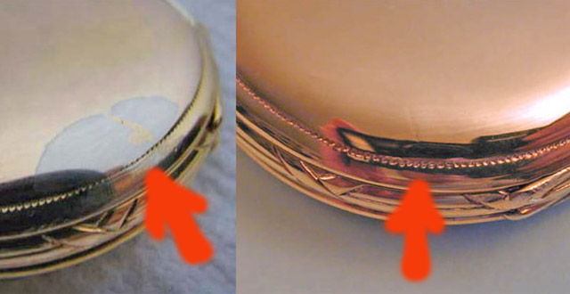

I need suggestions on what happened to this case. At some point the case was dented and I believe someone attempted a fix. My problem is that the gold has worn off to reveal what appears to be white gold underneath....not brass as I would have expected. Then, what do I do with this case? Replate? Live with it? I'm by no means an expert in anything watches, so all opinions are welcomed.

It is very hard to tell from the pictures... The first one looks almost like a film or haze, and the last one looks like someone may have taken the gold layer down to brass, feathered the edges and perhaps nickel electro plated over the area Confused
I think i would run down to the grocery and pick up somes Wrights Copper Cream 8oz. I would put a drop on my finger and massage it over the area. Then wipe off with a kleenez till the residue was gone and see what I had.
That would be my try at figuring out whether it was a residue type film or a nickle plated area. Either way it should either dasappear or expose the brass. Hope that helps Smile

Greg, What does the case look like on the inside? Is it still somewhat dented? If so it could be someone filled the dent in with solder and polished it. I have a case where the dent was filled in with silver solder on a yellow gold filled case and it looks just like your case. .....Keith

Keith it is somewhat still dented. I will try to take pictures of it tomorrow. What would be my remedy for this to make it "right"? This is an unmarked 60 hour and otherwise a very nice watch.

Looks to me like it was filled-in with ordinary lead solder rather than gold solder. Then it was probably plated by use of an electroplating dipping process that would cover the repair with a thin coating of gold which unfortunately rubs off all too easily. What they did was a cheap, do-it-yourself repair done to mask the problem for a quick sale, but as you see someone actually did more harm than good.
Now, it is still possible to do a proper repair which would involve removing the lid, smoothing out the underside, remove the mess, fill it and then correctly plate the lid using a commercial plating process. Proper repairs are complicated and expensive but well well worth doing.
I have a man locally who could do this work.

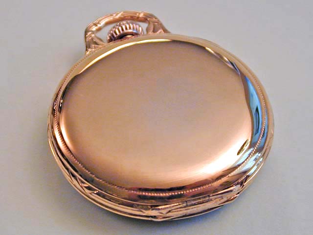

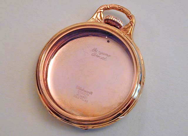

Our worst suspicions turned out to be factual.
The case was a mess but it is now professionally repaired and re-plated. Unlike before, all three hinges are now firm and the covers close securely. I found it exceedingly difficult to photograph as the case has such a brilliant, smooth and shiny gold finish. As I stated in an eMail to Greg Campbell, it satisfied Wink even me!
Quite a big difference and it is obvious immediately...
May 14, 2010, 18:25
Greg is looking forward to and has been patiently waiting for these images, I hope he likes what he sees.
These BEFORE and AFTER images really tell the story...
May 14, 2010, 18:25
Up front, we again see the excellent workmanship IHC Member Don Mathis, this entire case has been professionally re-plated for an overall look of originality.
A beveled crystal from William White completes the job, this will ship to Greg tomorrow.
From every angle this case has a look we can admire...
