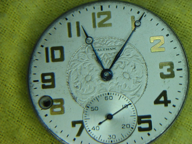

Dail out of the case
February 15, 2010, 20:31
Perry Howard
Dail out of the case.

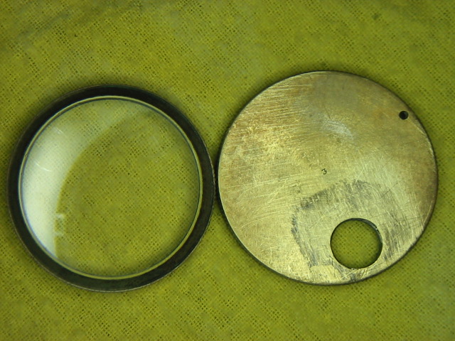

Case

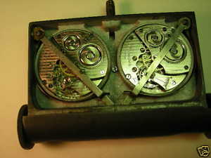

Pigeon timers were used in that era, I don't know exactly how but it had something to do with the racing bird arriving at the "coop" and a leg band was taken off the bird and inserted in a space in the timer. There was a bar across the back of the watch with a piece of piano wire that pushed into the balance and stopped the watch Eek A very crude "hack" feature or stop feature. That would explain the hole on the back of the case and would explain the same hole that goes thru the dial of your watch you pictured where the screwdriver goes thru the middle of the balance. Here is a picture of the watches used with the cross bar, no backs on the watches but I allow thats what the hole on your watch back would have been for. Tom is our go to man in cracking cases and I am going with that to explain it a bit better for you with Tom getting the credit. Thank you Tom, it was a "cold case" and you are the man Big Grin

Of all the parts to the case the one thing that really puzzles me is that little screwed on cover that seems the only purpose is to cover the numbers 22, I can't figure out why would you make a plate just to cover a number?

Perry's Watch arrived here and it is becoming very clear that it is some sort of timer. The large hole machined in the back cover is exactly in line to the hollow bolt showing through the front face of the watch. The large hole is threaded for a pipe thread that would hold a fitting that would guide a wire through the watch balance wheel and out the front only far enough to stop the watch until the correct time to pull out the wire and start it.
