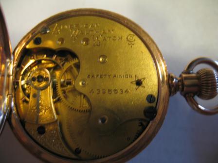

I have a Waltham 6s 7j model 1889 and I have a couple of dumb quesitons.
1) This is a hunter movement (obviously), is it also a pendent set? I ask because I can't seem to set the time.
2) What is the hole with the star around it on the movement that is in line with the stem? I looked at it with a loupe but could not figure out what it is or if it is missing a screw, etc.

Jim The stem setting mechanism on many of these becomes very stiff when they neeed cleaning. If it was lever set, the lever is at the 4-5 o'clock position on the crystal bezel.
The hole with the star is where you insert a thin screwdriver into a (unseen) slot in the end of the winding stem. That locks the winding stem so you can unscrew the crown and remove the movement.

Thanks Dave!
I was being a little tentative on pulling the stem.
