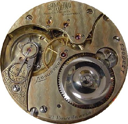

Here is a picture of another one..... this one is 1530623 (I believe) Which was in the 3rd to the last run of this model. Apparently some were for the Paillard Watch Co. and some were for Mongomery Wards.
Steve

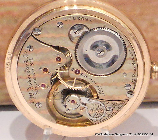

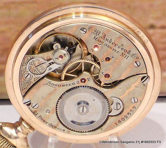

March 01, 2013, 11:38
Buster Beck
Sangamo Getty's 2nd Pattern "GoldInlayedRibbon" with PL's are not seen often
So this one is being "revisited" today as I didn't have pictures of the watch back then and I plum forgot about it !!
