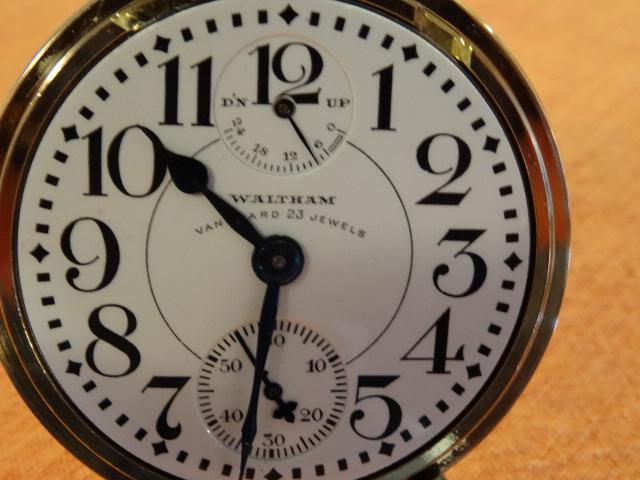

After sending the watch out for servicing last year and upon return the wind indicator hand is out of postion when wound. Everything was functioning prior to service and subsequent except the the position of the hand and direction when wound.
looking at the picture below when wound the indicator hand travels counterclockwise up to just left of 12 and starts count down from there.
My question is has the indicator hand slipped or has something been put in backwards? Thanks in advance Rick
Watch is a 16 size Waltham cica 1924 model 1908

Take the hand off, wind the watch all the way up. Then reinstall the hand on the 0, as the watch runs down the hand will rotate clock wise.

Just to add to Billy's post, I would try not to remove the hand to avoid any damage. Be very careful and take a toothpick, move the up and down pointer to just left of the up position. Watch the watch to see where the hand is positioned when it is completely run down. Re-adjust if needed.

I have to respectfully disagree with Tim's suggestion. If you are lucky and the hand is not pressed on tight you will get away with moving it with a toothpick. If you're NOT lucky and the hand is pressed on tight, you risk snapping a very small pivot on a very hard part to find. The proper way is what Billy suggested.

There is a good chance that it has not been put back together correctly after service, also a possibility the hand maybe loose and dragging, as Rodger says, I would not push it back to indicate correct position you could cause damage. if it is simply a loose hand it must be removed tightened and refitted I seen a lot of these watches have a few in the shop this week I often find this problem. if you want to ship it over would be pleased to take a look.

The issue I have seen with W.I. movement besides the simple possibility of a "loose hand" stems from their very clever set of differential gearing which advances the W.I. hand when you wind it from one "axle" and then reverses that W.I. hand rotation with the "run down" of the main spring from another "axle". IF for any reason there is some friction in that gear set they will interact with each other and cause the indicator to "reset" to a different place.

Experience over the years has taught me that the indicator hand is usually installed with a bit of "slippage" available. As a serious Wind Indicator Collector, I confess to having "adjusted" quite a few of them by using the soft eraser of a common unused, unsharpened number two pencil in a similar manner as Tim's adjustment by toothpick method.
Use great care in trying this method... place the unused, clean, soft, flat tip of the eraser in contact with the side of the hand and apply very gentle pressure... if it moves easily for you the adjustment should then have a happy ending. IF IT DOES NOT MOVE EASILY THEN STOP IMMEDIATELY rather than cause any chance of an internal issue or bending of the hand.
I find you can also use the soft, flat eraser surface to push inward on a slightly loose hand when needed.

I did, with great care, check the wind indicator hand and it moves freely.
I will however take the watch in for adjustment.
