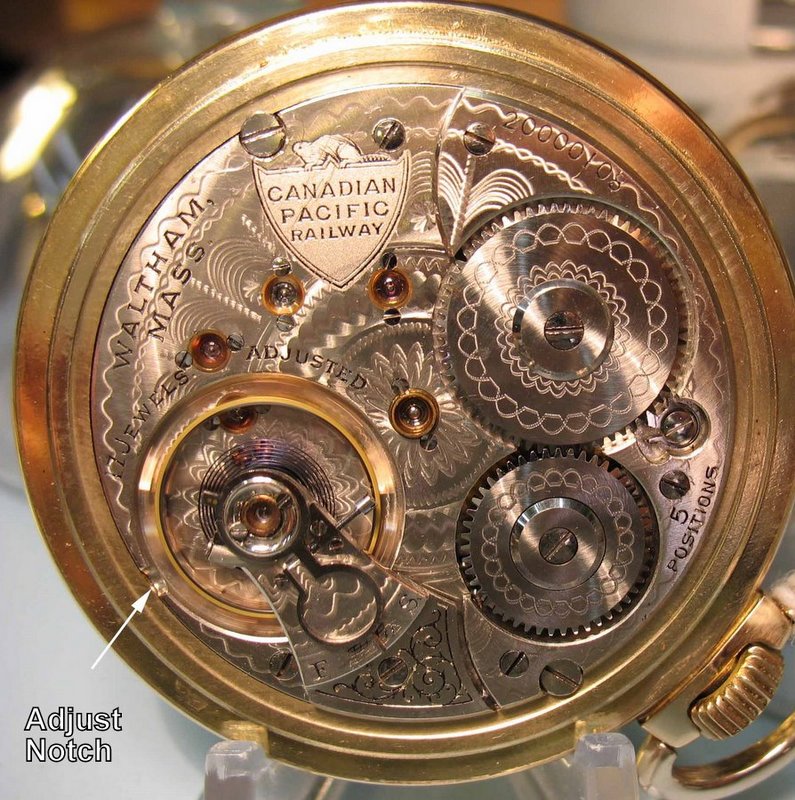

I've noticed something on some '92 model 18s Walthams and wonder if anyone would have the answer.Some of them have a small hole drilled in the balance wheel recess, right alongside the hairspring stud.I checked on the Model 1892 research website, and there's no mention of it, as I said some have it, some don't.Just wondering why that hole is there and for what purpose. Thanks!, Ted.

Krister OlssonHi.
I think Ted is meaning the hole visible in this image from the same source.
http://www.model92.com/_/rsrc/...2020641%20CPRCr1.jpgI've been wondering about that myself, but found no solution.
Regards, Krister.

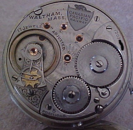

Theodore J. Brown Sr.Krister is right, I didn't mean the notch on the edge, which is to reach the meantime screws.I just can't figure out what that hole is for.I wonder if it's a locating hole for a dowel pin, or was for machining purposes.My 21J Vanguard and 17J Appleton Tracy have it,my 21J 845 does not.
August 16, 2015, 18:33
Theodore J. Brown Sr.I just noticed that the CPR that Dave pictured doesn't have the hole either, but that's a high serial number '92.Must have been dropped by then.
