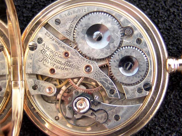

Thank you Sheila & Jerry for the information on the dial and case. Now for the hard one! Could you give me some information on the movement which I have posted for you to see. I think it's a 1908 and by the serial number quite an early one. Would I be correct in saying this? Thanks again for your help and will be posting some very interesting watches for you all to see in the very near future. regards,John
August 09, 2006, 11:16
Jerry Treiman
The Waltham serial number records list this watch as being from a group of assorted specials, so that does not help establish the model. The use of the Ohlson patent regulator suggests that it may be a 1908 model, but the only way to tell for sure is to remove the crown wheel and count the number of crown teeth. I can check my parts list this evening to see what the tooth count should be. I believe it should also have slanted teeth on the winding pinion (also need to double-check that). By the way, I have not heard of any 1908 model Riverside Maximus before this, so it may indeed be very special.
The fact that your watch is from a group of assorted specials is another indication that it may have been ordered special for Thomas Russell -- these groups of specials are usually for individual retailers.

Regarding dating of the movement, John's Maximus also has Waltham's recoiling click that was patented in 1909, so it is probably from 1909 or later.
Waltham used a number of patent micrometer regulators over the years. The star wheel regulator in the Shugart illustrations was one of Waltham's favorites and was used on many grades and sizes. They seemed to reserve use of the whiplash regulator (as on Tom's watch) for their highest grades and special orders, at least in the earlier years and up to around the 1920s. This may possibly relate to patent rights -- I believe the basic whiplash regulator was covered by a Reed patent and Waltham may have had to pay to use this regulator until the patent ran out. The Ohlson regulator (on John's watch) was patented in 1908 and is often associated with the 1908 model 16-size movement. However, I believe the correlation is not 100 percent. I don't have the details at the moment but either some '99 models used the '08 (Ohlson) regulator or some of the '08 models used the star regulator. As I indicated above, the only way to definitively tell the '99 from the '08 models is to look at the winding parts. The Ohlson regulator was also used on later 1892-model 18-size watches.

Have you had the opportunity to see the bottom of the balance cock (serial number)? The damascening doesn't appear to match, on my screen anyway, so that might explain the regulator ...irregularity. Wink

Here is an image of the distinctive winding parts from the 1899 model (on the right) and the 1908 model (on the left). The '99 has 26 crown teeth and the '08 has 33 spiral crown teeth. Some '99s also had spiral teeth (but still only 26 of them).

Firstly I would like to thank you all, Sheila, Mike, Jerry and Tom for the great interest and support you have shown in my Waltham watch.THANK YOU! Now this is the story so far. I checked the balance cock and Mike you were right, The serial # was different and I was shocked! and then remembered that I had given it to my Japanese watch repairer for a new balance staff. So today I took the watch to him and asked what he had done and found that he had changed the original balance cock with one that he had taken from a Waltham 23j Vanguard which I gave him for spare parts two years ago.Boy! did I get mad. I have told him to replace the original balance cock and when finished will send photos. Thanks Mike for being so observant. Other wise I would never have known. Jerry, thanks for the photo of the winding gears. I took a photo of the clutch on my watch,Which I have posted, but didn't take one of the underside of the ratchet wheel. Once the not so ethical watch repairer that I currently use finishes putting the balance cock back together in it's originl form. I will post a photo for you to look at. Well that's all for now until I receive the watch back.Thank you all so much and will post other interesting watches up that I have collected in the very near future. Regards, John

Jerry Treiman
John - just from the length of the winding pinion (between the winding teeth and the ratchet teeth) one can see that yours is an 1899 model.
It is remarkable, and often disturbing, how utilitarian some watchmakers can be when they do not appreciate the historical values that we try so hard to preserve. Rather than replacing the balance staff your watchmaker may have just swapped complete balance assemblies, in which case you may no longer have the original balance wheel either (the watch serial number is scratched on the underside of the balance arms). He may have done this because it was easier than finding a replacement balance staff in Japan. If this is the case and you (or he) needs a staff and is having trouble getting one to restore the original balance, please contact us and we will find you one to restore this great watch. It takes a friction staff and the blued-steel hub should remain in the wheel.
