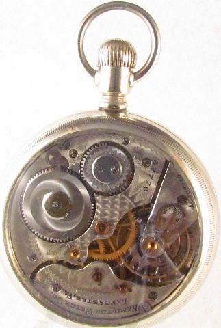

Take a look at my Hamilton 972. It is running face up and with the bail up but stops face down. I still need to clean it.

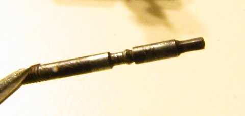

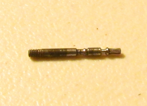

This was really a project to put together my 972 to see if it would run and to attempt to make a winding stem. Thanks to Dan Carter and Jared Brinker for providing me with some photos of the old special winding stems these old Hamilton's used I was able to make one. The stem I made works fine.

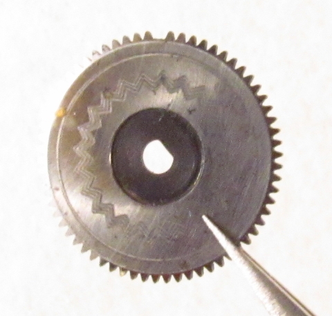

After making the winding stem I needed to replace the mainspring. After changing the mainspring I noticed a tooth missing on the winding wheel so I replaced it with a winding wheel off a 975. So if any of you good people here have a winding wheel that matches I will be more than happy to take it off your hands. (Got one from Edward Kitner)Thanks Ed. There will be a picture showing the pattern later.

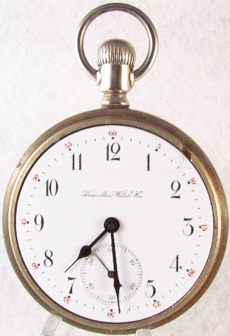

Not wanting to mess up a good case I put together this case from parts and polished it. The case had one crystal that was very scratched up so I polished the scratches out. The other side needed a crystal and the only one I had to fit was scratched up so I glued it in and polished it. So this IS NOT a salesman case.
I did not have any hands for it but I had some new "Favorite" brand hands made for a 16s Hamilton so I put them on.

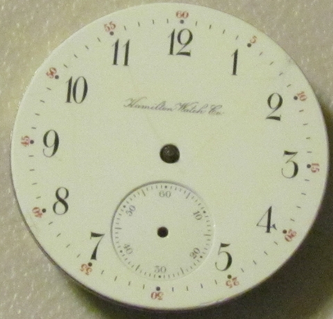

I did clean the dial to make it look better.
I know that a lot of people will not like the fact that this watch is just pieced together. I will be exchanging parts as I get them to make this correct. REMEMBER this was an experiment to see if I could make a stem on my lathe so I still have a lot of work to do but I am very happy with the results so far.

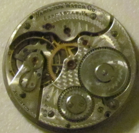

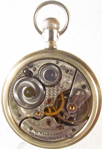

Picture of the movement as I got it.

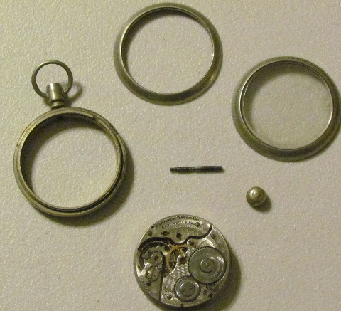

Scrap parts that I put together to make the watch. NOTE the stem I will cut down later.

Close up of stem before cutting.

Close up of stem after cutting and it works perfectly.

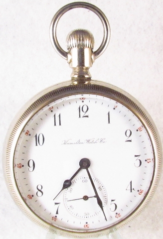

Finished front view.

Finished rear view.

Rear without bezel. Notice the winding gear from a 975 does not match. I hope one of you have a correct one for me.

Winding gear showing broken tooth. I sure hope one of you fine people have a gear that matches his pattern so I can make this watch complete. (Got one from Edward Kitner).

Harry I applaud your accomplishment. You resurected a Hamilton watch from the parts bin. Nice job on the stem. I needed one and was lucky enough to have a friend that had an extra one.
Now I get to help you, I have a ratchet wheel that matches your crown wheel. Send me your address.
