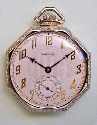

Recently I was looking at this interesting 12-Size Waltham in my collection.
It has a good looking dial and is housed in an attractive solid-gold octagon style case.

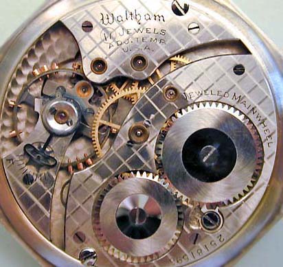

As you can see in the image it has a very attractive movement. But the markings seemed a little unusual to me. Train bridge is marked "Waltham" and then "17-Jewels" but what struck me as peculiar is that circle around the "17" numeral. I recall reading about and seeing Waltham Railroad Watches that had been up-jeweled and then a plug inserted with the new count.
Adding to my confusion I looked up the serial number 25181596 in Tom McIntyre's Database and it came back as being a 19-Jewel Grade 239 movement.

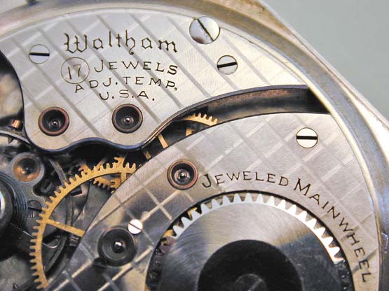

Here is a closer view of the markings. You'll see the circled 17 and the "Jeweled Mainwheel" as well. I'm not entirely certain what they meant by that one so any information about this watch and its markings might prove helpful to me and interesting to others as well.

This should have 19 jewels, with the jeweled mainwheel, unless a couple of the visible jewels are not matched by another under the dial. This movement is certainly unusual and should be explored further. The markdown to "17" certainly looks like factory work.

So is that "17" a plug like we sometimes see in Waltham Railroads?
And just exactly what is that "Jeweled Mainwheel" intended to describe?
May 02, 2006, 19:03
Jerry Treiman

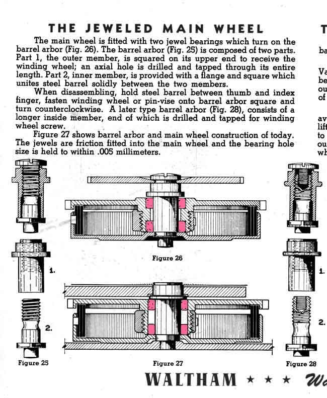

Yes, I am fairly certain that it is a plug. The Jeweled Mainwheel is the upper toothed part of the mainspring assembly that drives the center wheel. It has two large "doughnut" jewels that embrace the winding arbor. On most of Waltham's 19-jewel watches these are the two extra jewels beyond the basic seventeen. They are not visible unless you take the watch apart. The jeweled mainwheel is otherwise functionally the same as Waltham's typical safety barrel.
May 02, 2006, 20:50
Jerry Treiman
Here is a cross-section view of the jeweled mainwheel and barrel (color added), from a late edition of Waltham's Watchmakers Handbook.

It would have been one heck of a trick getting the demascene lines redone on the plug to match the plates. Wink The plug must've been put in before it left the factory. But why?

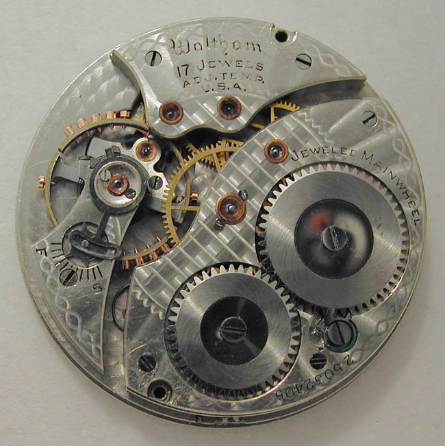

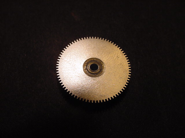

Finally got a chance to disassemble my watch. As per the pic enclosed, the hole in the barrel top plate is jeweled with two jewels as shown in the diagram above The pic shows the arbor removed. The jewel material is clear so makes it hard to see in the pic. There is no jewel in the pillar plate. So, in essence, this watch is a 19J watch and not a 17J as marked.

I finally received another example and immediately tore it apart. It definitely has 19 jewels. This example, from an earlier run, is not as nice as Lindell's in that the plug is not damasceened to match the plate.
