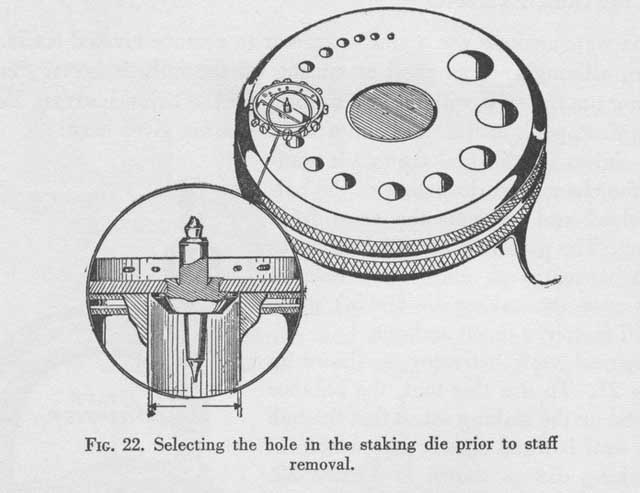

If you are referring to the 4th wheel as that which has the seconds had on it, I would be a little worried if the original has a broken tooth and inspect the escapement wheel and pallet for carefully for damage.
If all else is well, then check the diameter of the "wrong staff" that is in the replacement wheel you have to make sure that it is not larger than the staff on your broken tooth wheel. If it is, you need a different replacement 4th wheel. If it is the same size, then you might get away with pressing out that staff and the staff from the broken wheel and exchanging them.
The below picture shopws how you choose the correct hole in your staking tool to place the wheels for staff removal and reinstalling the staffs.

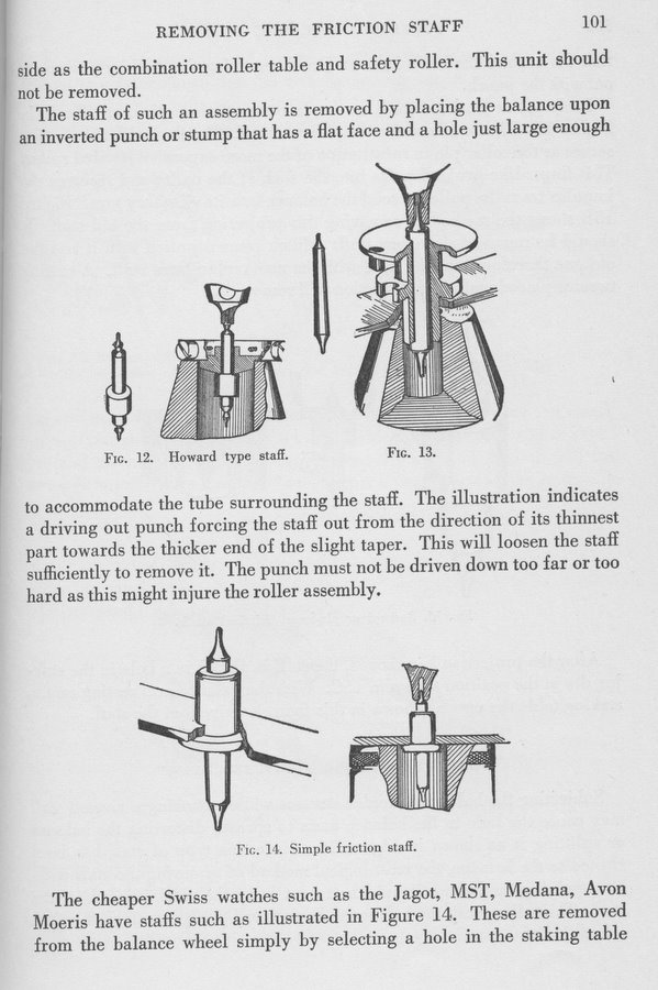

September 19, 2009, 16:01
While the pictures and text are for balance staffs the only difference to your staffs are they are easier to do. When you have the right hole in your base plate you have to align it with the alignment tool in your staking kit, tighten the hand screw to hold it there and then pick a stake that will press out the staffs by way of the pivot end as pictured. As many of these are tapered, you have to measure the staff shaft and place the "small side" up when pressing it out, and then press the small end of the staff in first when re-assembling it. Of course you also need to makee sure you accurately measure the depth of insertion to make sure the wheel is "stacked" correctly when in the movement.
