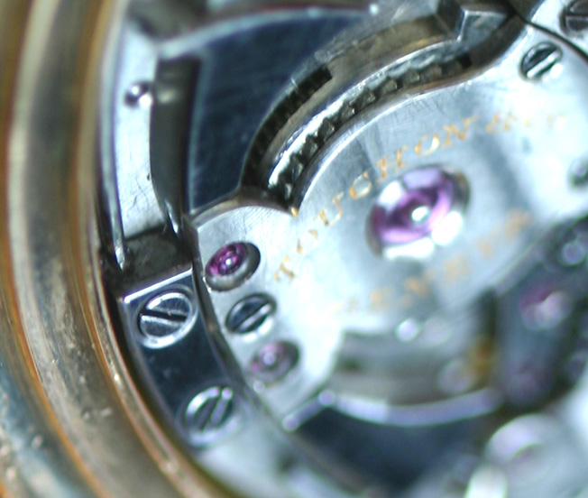

here is a photo of the gong block with the missing gong
Any advise is greatly appreciated.

Ho,
Nearly all have two gongs, however there are some that use a single, from what I see yours if changed the complete gong assy has been changed otherwise I would expect to see a hole or evidence from the deeply set gong in the block, I have seen then missing and the silver solder broken free from misuse. A few interesting point are that double are normally set one high one low to achieve the separation the single one in yours looks to exit central from the block and beautifully formed so the entire gong assy would have been changed the block shown looks orignal wihtout modification, now if that is the case you may find a gong or make one to replace a mangled one but where would you find a block to mount it , if that was made by hand and the person had the skill to make it he would have not made the pair. If it was mine I would defiantly seek as many examples possible, I could before changing anything it may well be correct, there is a definite sound difference produce from the different sized hammers striking enough to read the time also the single gong is perfect length to pick up with good ring tone both hammers a excellent job if it is not original!

Ho,
I agree with Chris, it looks like that is the way it is supposed to be and after watching the video, it sounds like it was designed to work that way. I heard the 11 strong single strikes from from the the hammer near the ring base for the 11th hour, 3 double hits for the 45 minutes, and 14 single strikes from the hammer at the outer end for 59 minutes. All creating a diferent tone. It even seems the delay between the two hammers were designed that way.
Further research may determine that this is in the original condition with which it was made. An outstanding timepiece I might add.

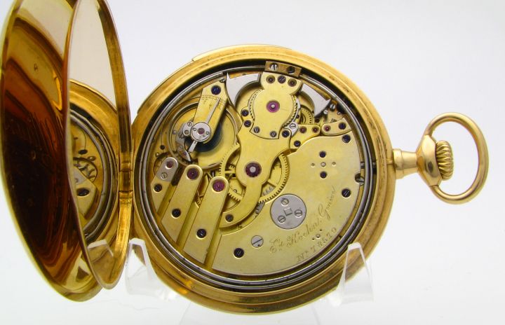

I cannot add much other than to say that your repeater seems to have been designed to have just one gong, unless the present assembly is itself a replacement, since the block holding the gongs does not have a hole for a second gong. Except with respect to this watch, I have never seen or heard of a single gong minute repeater, but I make no claim to special expertise. I have attached photos of my Touchon minute repeater, which has two gongs, but is of a different design than yours.

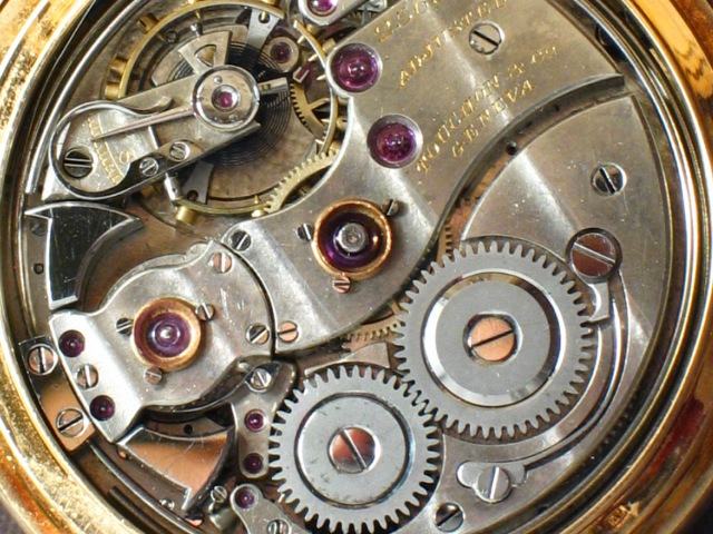

This is the picture of the complete movement.

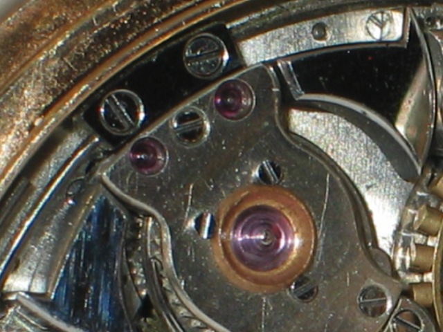

From Ethan's repeater, my gong block looks the same as his.

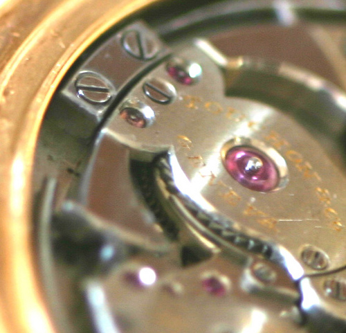

Here is another picture of the other side of the gong block with the gong.
This is a beautiful repeater and I hope to restore it to the original state. Seeking further advises if any.

I have a theory that might confirm or disprove your conjecture that your watch originally had two gongs, but that the gong "block" had been ground down to eliminate the hole into which the missing second gong slipped. That block has two screws. I assume they are set screws holding the gongs in place. If the one existing gong is only held in place by the right set screw, and the left set screw serves no other purpose, it would appear that your conjecture is correct. However, if the left set screw currently serves a function, such as holding the existing gong in place, that would suggest your watch is a one gong watch. Please remember that I am not a watchmaker, that I have never removed a screw from a watch, and that my theory may be all wet.
