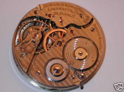

Which one would you say this one is....
Besides being very dirty....

Doesn't look gold to me!!

It is rather confusing as the Hamilton ads.Say the 992's have a gold center wheel.Anyways seems the more I know the dumber I get. Regards Roger

sure looks gold to me!!!! Wink or yas used colored light LOL

However, it looks like gold to me too.

Hi Jerry,
Iwould expect your watch to have a GCW. It appears to be a "teens" or above watch. I think that possibly the only 992's without a GCW will be from the pre-teens and more than likely it will be a first model fancy damaskeened before Hamilton went to the narrow stripe 992 pattern damaskeening.
Most of the non gold plated center wheels I have seen on 992's came from the fancy 1st models somewhere around the transitional period changeover from the fancy pattern and from 4 foot to 3 foot dials Eek

The s/n is not readable in the photo, but it is #2462777 which dates the movement to 1927....it is a 992L....
I bought the movement from one of these watch canibal's without a dial, hands or case.....I have found hands for it but I still need the appropriate dial and case....Then I'll send it to Chris and let him clean it up and put it back together again....
