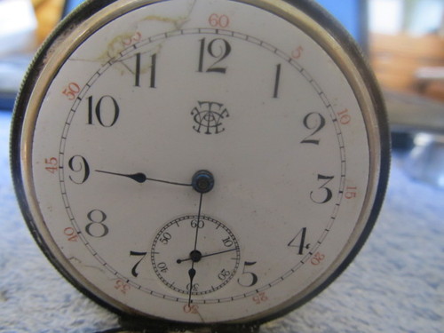

Does anyone know what this is? TWC?
I can't figure out what this dial is. Any clues?

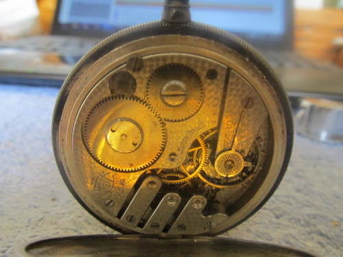

It goes with this movement.

Trenton Watch Company, they used their initials on some of theirs. A model 3 pendant set open face.

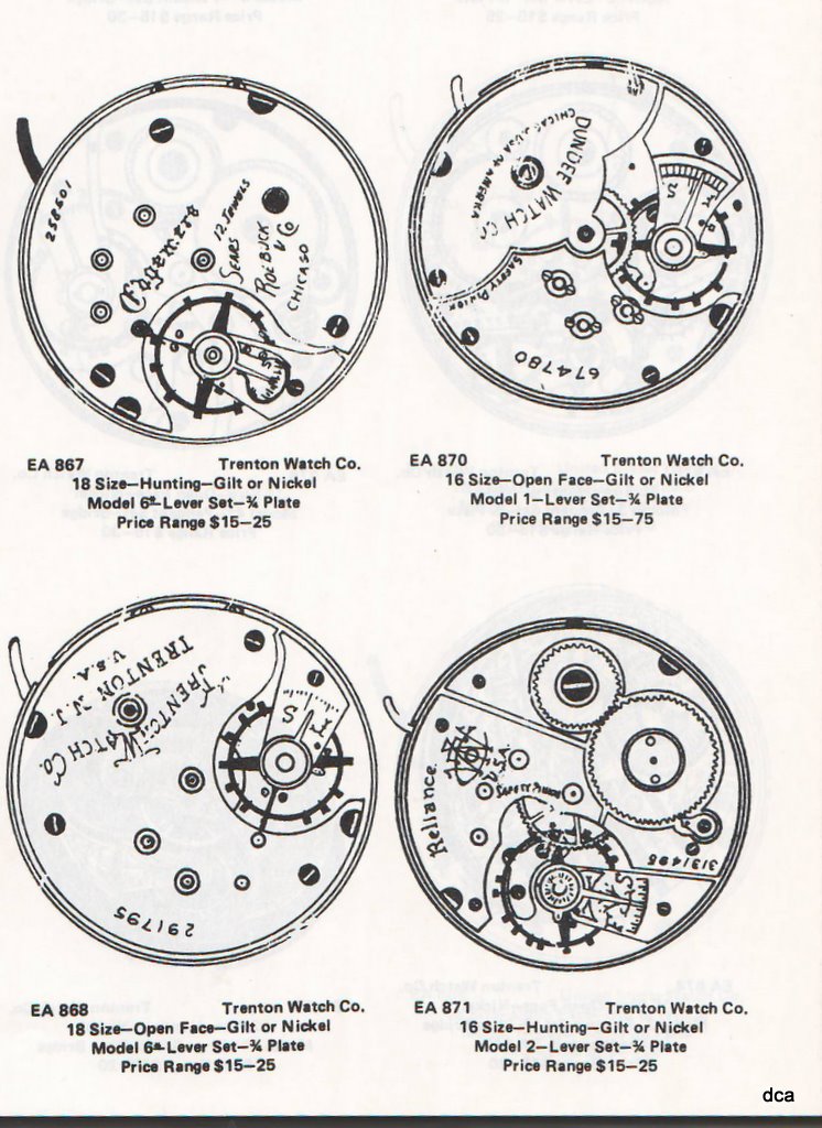

The "T-W-Co" for Trenton Watch Co. is on your movement too in the lower left of the image you posted above. You can also see it in another Trenton from the Erhardt-Meggers "Gold Book" in the lower right corner. Yours is a nice example. Soak the dial, clean up the movement (carefully, they are a little rough around the edges) and you will have a nice colletible!
