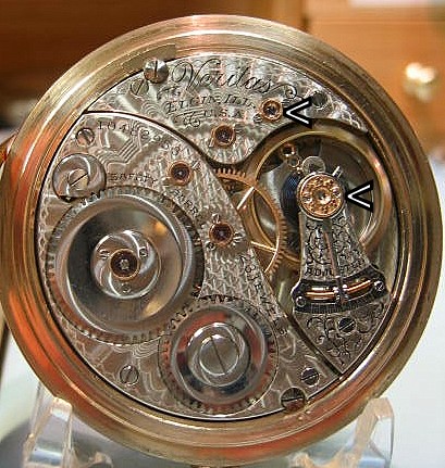

David AbbeDavid, Diamond endstones began showing up in early 19th century Verge escapement Pocket watches and continued in use on the higher end US-made watches until the nineteen thirties. The Diamonds were always easy to verify because they were Faceted as would be a cut diamond. Closer inspection is sometimes required, but you need only look for them on the higher end Waltham and Elgin watches. A 23 Jewel Elgin Veritas that passed through my collection a few years back has the Balance wheel pivots capped with a Diamond Endstone pair. I think the Escape wheel was also fitted with a pair of Diamond Endstones.

David AbbeChris, you answered your own question. ONLY Diamond Endstones are "cut", or "Faceted'
