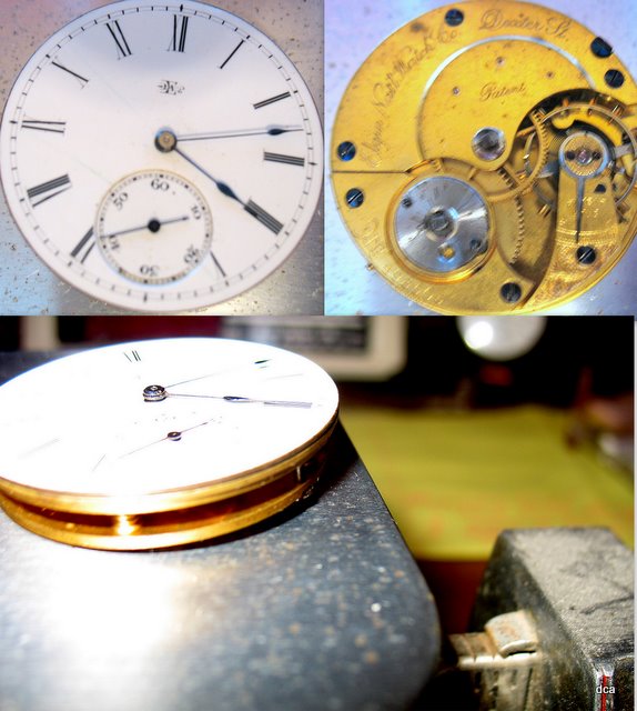

David AbbeWell . . . I just happened to have a Dexter St all complete even with the hands. To calculate the "true value", I performed a high precision "weigh-in" with my pilfered 1966 vintage Pitney Bowes postal scale. This allowed a journey through` my usual grandiloquent thought process to develop a “value”! The result is:
Mvt weight: 1.187 Ounces
Case/mvt you measured; 2 OZ
Net Case w glass and ferrous stuff; 0.813 OZ
Net case (less 15% for stuff); 0.69105 OZ
Case in Troy (Gold weighting) OZ; 0.629863
Value @ $1800/Tr OZ $1133.75
@0.800 (18K); $907.00
Dexter St. (if working) $75.00
Total $982.00
Insurance ValueNot too far off after all! So long as gold stays up there. I would barter for $750.00.

I would caution against trying to "wrangle" any other movement in your case. The Key wind Dexter St. has only one case screw as you can see by Dave's pictures.....
If you look close at Dave's pictures, in the top right picture of the gilt movement on the edge/rim of the movement beside the barrel, you may notice a small silver colored teat... That fits into a drilled small hole that will be inside the case rim of the case itself.
One can get into big trouble when trying to adapt other movements into a case that was made for another particular model
There is a lot of pleasure one can get out of an original combination even though it may not be a high~grade and it will be worth more when it is sold if it's left as factory original
A lot if not all the early movements with one case screw showing will have the teat on the edge of the movement. Down thru the ages with people "recasing" these early movements or swapping them out case, movement, etc., they have to end up filing that teat off to fit another/different case. Then they will never fit the case the way they were intended and may even effect the running of the movement
Just so you will be ahead of the game
