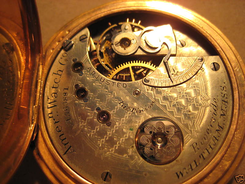

Hi,
I thought this was different, I got outbid on this one, but I still would like to know about it if you can help.
I did get the information from the Waltham database, but I don't think it tells the entire story. If you can add anything to it, please let me know.
Serial Number 1763881
Waltham 1763881
Sheila
February 06, 2009, 22:27
What little I can say is it is a 14s 1874 model, came with both the heart shaped or tadpole regulator & the simple regulator, it was adjusted to positions.

TOM!!!
That's it! I knew I had been shown this before, but until I saw your mention of the TADPOLE I was at a loss.
I think that maybe I had also been used to looking at Getty's lately, and something seemed to be missing. Like a click maybe!!! hehehe
Sometimes my brain just doesn't click either huh?
Thank you!

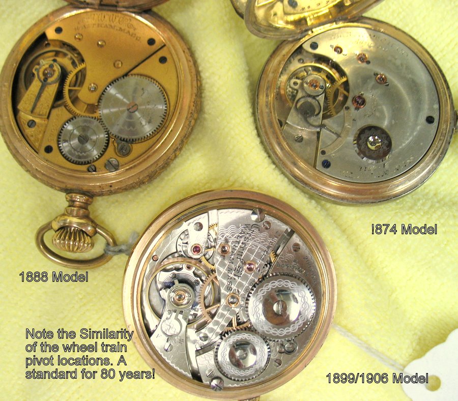

Sheila, I see this design as the Spearhead of the Whole series of designs that Waltham evolved from the 1874 design all the way through 16 sized models; 1888, 1899, 1908, 1912, 1945 series. The variations in Plate cuts had little to do with the train construction. The major changes were the addition of a Motor Barrel 30 years ahead of the rest of the industry, and the eminent durability and serviceability of this model. It was (I think) one of the "Nashua Group" (of Geniuses) designs. It became the "Backbone" of the Waltham Watch Company. I think the model 1874's simple, reliable but delicate appearing design gave proof of the technical and spiritual prescience in that group of engineer/designers.
Had Illinois seen fit to continue refining their Getty design rather than "caving in" to the "de-facto Industry Standard" stuff, they may have been the ones buying Hamilton later on.

Sheila, I remarked the picture so you can follow from my photo to your diagramp. All three movements in my picture have the same "Wheel Train" pivot locations for the wheels as marked;
Pic = Your Picture
CW = Center Wheel
3W = Third Wheel
4W = Fourth Wheel
EW = Escape Wheel
This means the basic design is the same.

Oh my Goodness! I see it!
My picture is different, but I see what you mean.
Wow! that is great! sorry for my hard head, but his explains it very well for me.
When I look at the different watches, and compare, it makes all the difference!
I have no idea why I couldn't see it before, but I sure do now. It's finally clear.
Funny how sometimes it takes that ONE SPECIAL WAYS of seeing it, to work.
