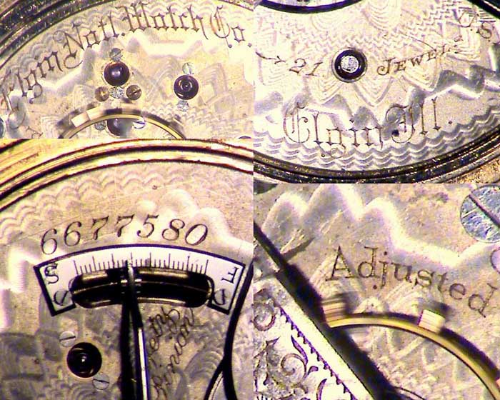

Claude, you raise several interesting poiints. These went through my head when I listed a 149 that closes this coming sunday;
http://cgi.ebay.com/ws/eBayISA...ageName=STRK:MESE:IT
IHC Life Member
Picture of David Abbe
posted
First, Market;
a. Elgin correctly judged (in their view) a market for a good 21J full plate movment that used their much more accurate and reliable Anchor Pallet Fork design. The Waltham 1883 was stuck with an antiquated pillar plate supported Stright Lever Pallet that was simply NOT truly 5 position adjustable!(My opinion). Probably (in part) for that fact Waltham only made 400 of the 83's in 21J.
b. Waltham had gotten the "drop" on the watchmaking business with their "faux" 3/4 plate looking (no pillar) design model 1892 that DID allow for 5 position adjustment, forcing Elgin to "buy time" by upgrading whatever they could in 18s Full PLate design to 21J RR Movements. Hence some 149-50's, Father Times, etc.
c. Ultimately that paid off by allowing Elgin to create and market the Model 8. The Elgin 18s Model 8 is the ONLY TRUE 3/4 plate watch everr made and the finest design 18s watch EVER offered to the US Market! Bar None!
Second, LEVER SET DESIGN;
After working on Elgins from Abbot converted KWKS up to and through the 149/150 watches, all I can say is that for reasons only known to Elgin, they went through enough Lever setting design variations to arguably compete with the complexities of life described by Darwin in his "origins of Species"!
Still, the 149 is a fine piece, not intended really for Railroad use, but adjusted to that level indeed.

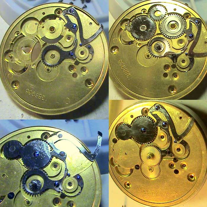

Claude, recently I posted on one of the first (and most complicated) Elgin Lever set designs which by virtue of the fine toothed planetary gear arrangement was (can I say) "lacking in robustness".
