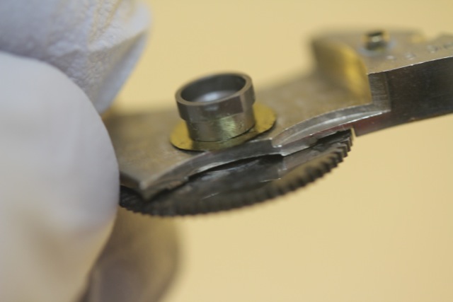

In the process of cleaning the ratchet wheel (this was the last thing I did after my 3 hour cleaning marathon since the wheel bottom was so rusted that I could barely turn it) I did everything wrong and was reading one post behind the correct thing to do to get the wheel separate from the hub. At any rate, I broke the arbor barrel hub, and the ratchet wheel Frown You have probably seen previous posts asking for any leads on the parts. I was able to track down some possible parts from our own Tom Brown and from Casker Co. The verdict is out as to whether or not I can get this old 952 back into top fighting order as the parts are still in transit.

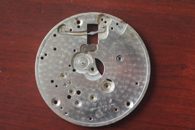

This is the back of the watch pre cleaning ...

This is the busted ratchet wheel and arbor hub ...

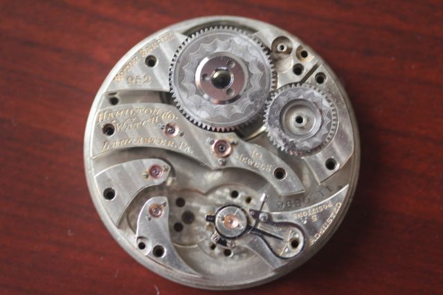

This is what the movement looks like after several cycles in the ultrasonic cleaner and a light buffing with Simichrome ...

And here is the Hamilton 952 19 Jewel ...er ... 17 Jewel pocket watch in its intermediate form (974 Ratchet and Crown wheel so they match and the 974 barrel). It winds, tics, and is keeping ok time (has not been adjusted of course ... that will come when I get the right parts). I do not intend to run this watch anymore or carry it, but it does work!

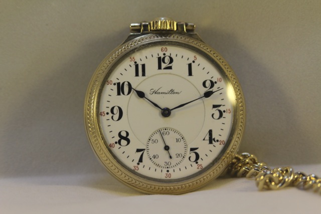

Ok, here is the watch in its pretty much complete form. The only way it will change is if I get another case (I ended up putting it in a swing out, and I don't really like those for this type of watch, but it looked good), or if I get the right spiderweb design ratchet and crown wheel. So this is after adding the Bonanza gold inlay and polishing things up a bit. Thanks to everyone that provided input!

Coming back to update the postings here, but I did some more adjustments to my 952 based on some trial and error and just plain luck. As it turned out, the old ratchet wheel still had some threads left, so I was able to use one of the arbor hubs from the Cask-ers "variety-pack-o-hubs" on the old ratchet wheel. It was one that has only a few threads and I think would fit into a ratchet wheel from a later model 950 (one that does not have the shiny ratchet wheel jewel cap, and instead would only use screws to hold the ratchet wheel jewel in place. So with that being said, it was a touch too long and in order to keep the ratchet wheel from being lose and moving up and down when I winded the watch I used a 18s brass hour wheel washer to make the fit tighter. It works fine and does not bind the mainspring barrel best I can tell (might revisit this and shave off a bit to make it smaller). Now I have the original ratchet and crown wheel with the spider web design and even with the petina I prefer them over the plain replacement wheels.

This is of the mainspring arbor hub repair:

And finally the 952 cased and ready to carry! (I know it is the wrong case, but like I said, it is the only glass-back I had left, and I really like showing off these fine movements and watching them work).
