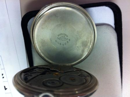

I am planning on giving this watch to my oldest brother for his 64th birthday this weekend. This was our father's watch that I came across while cleaning my basement up. I took it to our local jeweler who changed the crystal and got the watch working again. Can anyone provide me with additional information and the value of the watch? Here are some photos - Thanks - The initials on the front are CEM - Charles Edward Meldrum - my Grandfathers, Fathers, and Brothers Initials. My father was born in 1918 and from my research this watch was made in 1924-25 so I suspect he inherited it from my grandfather. I will try to post more photos

inside cover
cover

Mark, Nice watch. The serial number from the movement will help give much more information about the watch. It is not quite readable in the pictures.

The watch itself has a serial # on the movement of 4677273.

Your case with "585 Fine" is proof of it being Solid 14K Gold which is very important to recognize.
Movement number 4677273 is a 12-size, Pendant-Set, Open-Face, 19-Jewel, Model "3XT" which means "model 3, Extra-Thin" when deciphered, A. Lincoln Grade 527, Adjusted to 5 positions, Heat, Cold and Isochronism. It is a high quality, well finished movement featuring a Jeweled Motor Barrel and dating to be from late 1925 production. These were produced from 1925 through 1928 making the original sale most likely during the mid to late 1920s but that that detail was not specifically recorded in the factory records. You might want to try and find out if documentation or recollection of the watch exists within your relatives, this is a really great family heirloom!

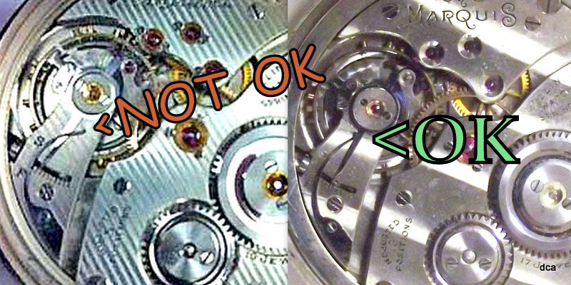

Welcome Mark! Very nice watch, and amazing history! However, you might want to have whoever worked on this to put the regulator whip back behind the regulator arm where it is supposed to be. Best regards, Brad

@Brad – Thanks for the info on the repair. I wish I knew what part you were talking about. I had this watch restored about 2 months ago in preparation for my brothers birthday this Saturday. When I first got it back, I had trouble keeping it running and took it back to the jeweler. I found out that the watch repairman passed away a few days after restoring this watch. I just shipped the watch to my brother in Florida, I will pass the information onto him.

Mark, below I pictured your movement on the left with the abused whip regluator and on the right an unabused regulator on my 3XT Marquis with a graphic. The A. Lincoln can be easily fixed by an accomplished jeweler if your brother shows him this picture.
Leaving that very valuable and high quality A.Lincoln watch movement in that condition does not speak well for the "expertise" of the person who recently serviced it. The professional treatment of this grade of watch is best available from our own Chris Abell at;
http://www.abellwatchmakers.com/
