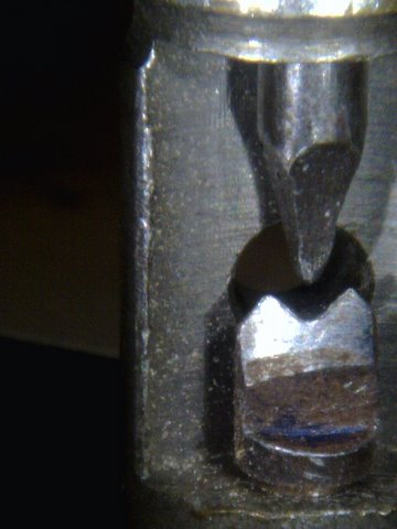

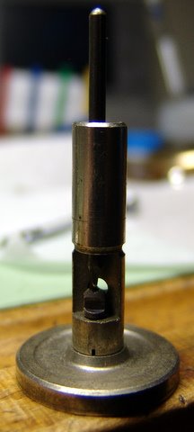

Tom BrownHere is a photo of mine, hope it helps.
January 18, 2009, 10:14
Tom BrownRoger
I guess we were both posting photos at the same time, sorry to butt in.
January 18, 2009, 10:25
Roger J. NolfeNo problem Tom...Just shows there are so many different tools to accomplish the same job!

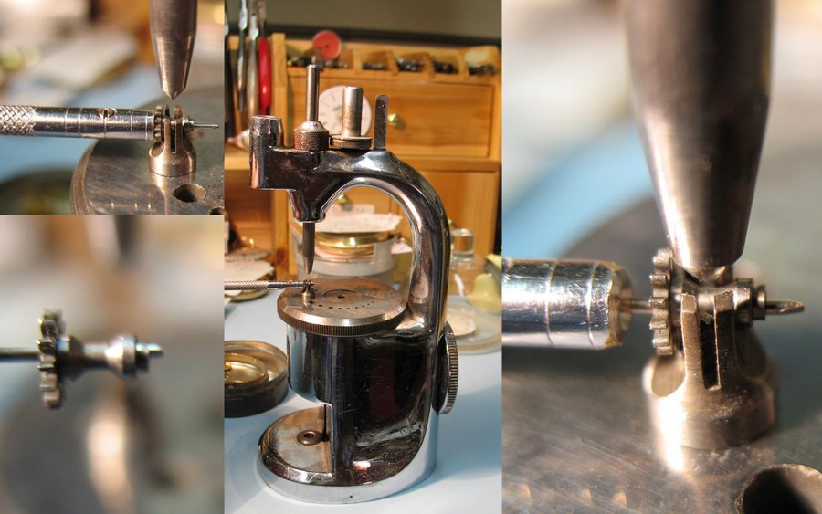

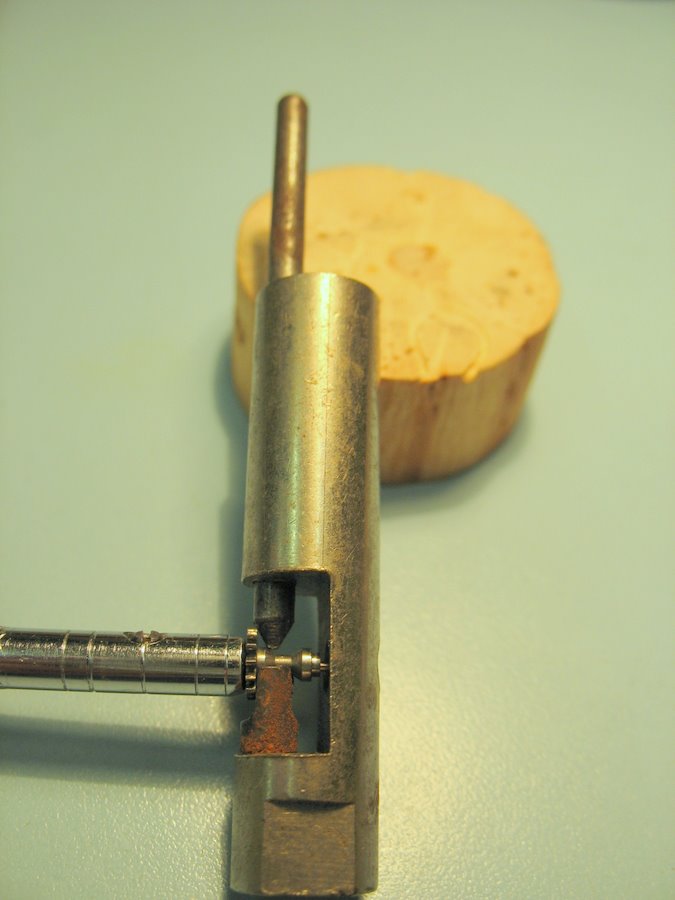

David AbbeI "gotta clear the air" on this subject. Roger's tool (his particular one looks like it handles wristwatch cannons too) is what I call the "neat one" because it has altogether the cannon pinion support shaft and a "V" anvil to support and stabilize the cannon pinion. With a "neat" thumbscrew type "non-shocking" embossing tool to
GENTLY tighten cannon pinions. (Such as the 1883 18s Waltham cannon pinion That serves as the "model" in these pics). However this is more limited to solid body pinions. The less robust pinions such as all the Hamiltons . . .
January 18, 2009, 15:34
David Abbe. . . need the "real thing" setup which is provided by most staking sets. This allows more careful manipulation of the pinion while gently tapping it to make the center a little tighter on the main wheel shaft . . .
January 18, 2009, 15:36
David AbbeThen there is the "hammer and hope" design. I do not recommend this unless you are desperately interested in finding another cannon pinion after you break the loose one.

Roger J. NolfeDavid...Thank you for posting the pics showing my tool in use. The person I got it from showed me the wrong way to use it! It now makes total sense that this is the proper way to use this tool. I will go back and remove my eroneous instructions on how to use the tool. I love this forum!
