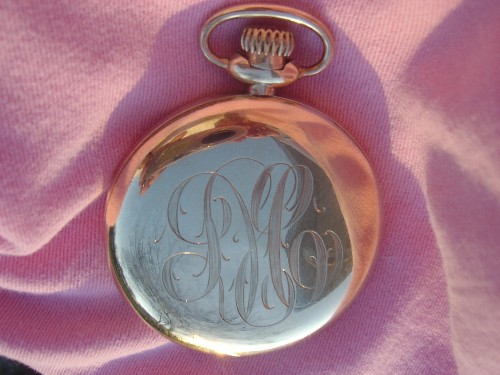

January 28, 2012, 18:20
Bill Churchwell
grandpa's
