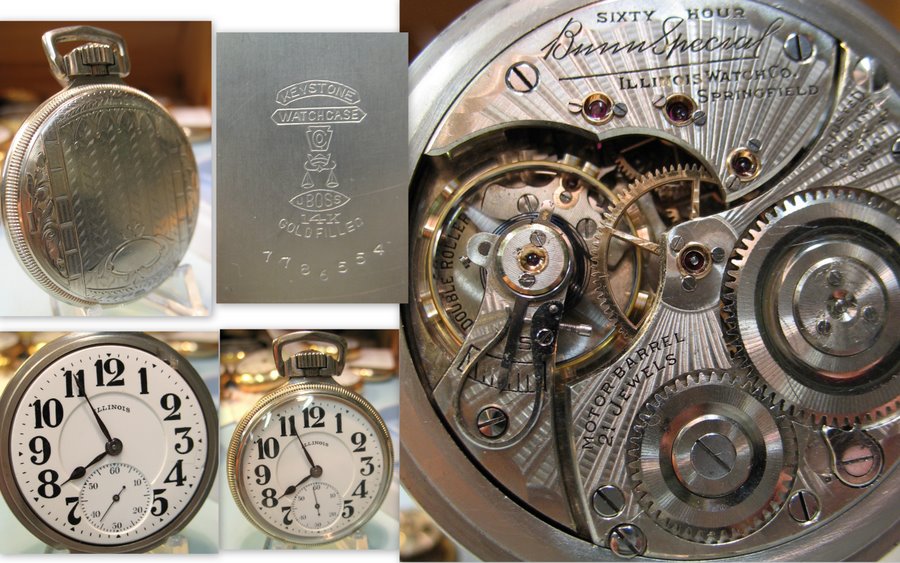

Another fine Bunn Spcl saved! Thank you Lindell
https://ihc185.infopop.cc/eve/forums/a/tpc/f/1086047761/m/63910433
March 02, 2009, 00:49

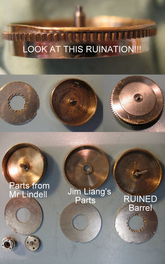

I made a "revoltin discovery" while restoring a nice model 14 Bunn Special. How could the "motor barrel" be so butchered! Jim Liang sent me a new barrel that required machining the center to refit the old spindle post, and then "outa the blue" came Lindell, SUPERWATCHMAN!!! with a complete set of parts. Let me explain that this Model 14 is the last Bunn Special ( made by Illinois before Hamilton takeover) before the 161 - 2 - 3 series, and this 60 hour motor barrel is SPECIAL TO only this model 14 and all the later numbered ones, and those parts no longer exist!
March 02, 2009, 00:51

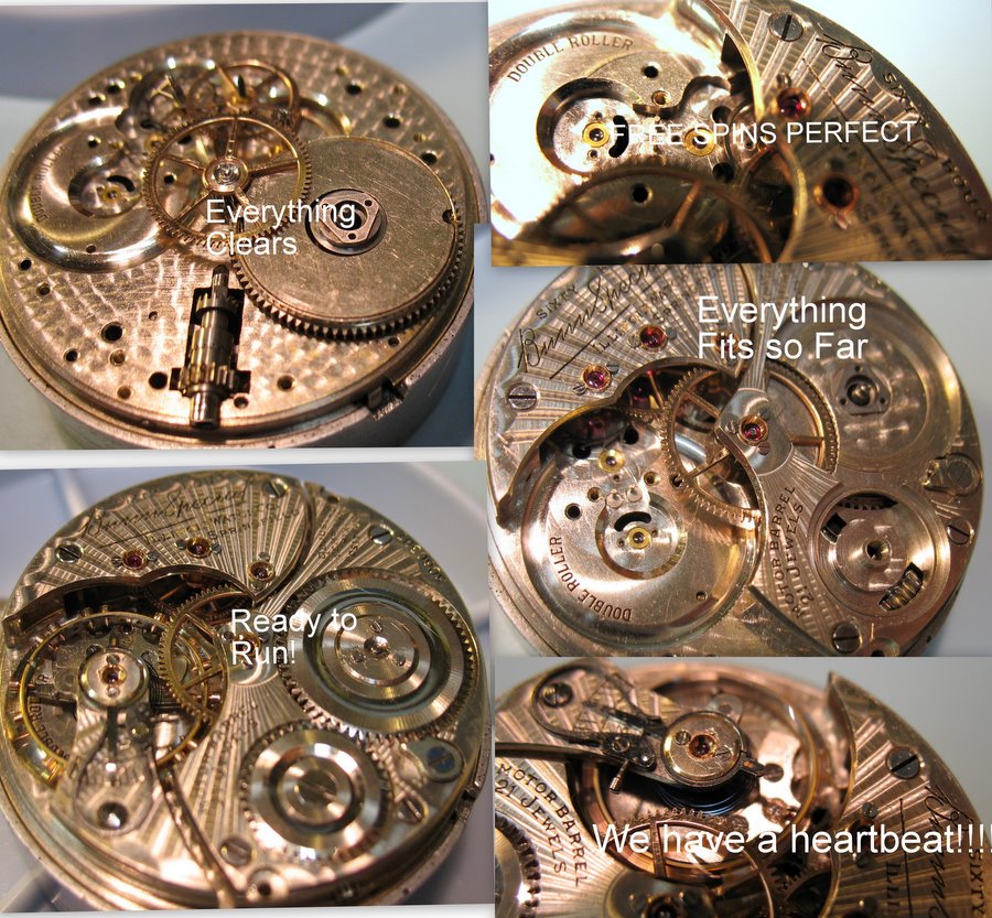

So with "tongue in cheeck, I went through the re-assembly of said beauty with Lindell's incredible parts find . . .
March 02, 2009, 00:54
So thanks to Lindell, and everyone who supports IHC185, another fine watch has been restored to its best possible condition. What a beauty! (btw I do have a "grumble", the Illinois "motor barrel" sure looks like a "going barrel" to me.)
