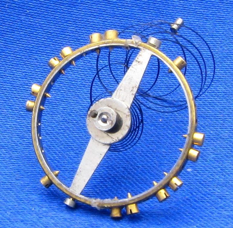

This is a first for me!
Sitting here everyday I see all kind of quick fixes from simple glue to special broken staff extension jewels Big Grin but this is a first for me to find this, the arms of the balance glued together Eek
Hairspring looks a little tired also....

Well that does take the cake! Do you think they really thought the wheel had broken since it was split?
Let me see the hairspring after you put that back in a coil.

HI Chris, Yes,this really takes the cake!
But honestly,...are you really going to be able to put that hairspring back to life? I am asking this because I spent countless hours straightening up badly mangled hairsprings with mixed results and I know how nerve-wracking this kind of activity can be!

The hairsrping was creased so would never survive any shaping, either way a bit far gone, the upper and lower jewels where totally smashed also, this was a good case for a dive in my parts watch cabinet!.
Must have been a big blob of glue its all over the screws also. Forgot to mention both pallet jewel where upright after being forced over the escape wheel Eek that amount of force also broke the escape pinion. Other that that its just needed a clean...........
