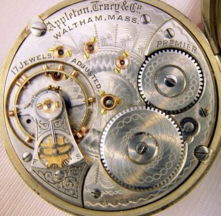

After I posted the above, I found these images on the web, apparently Ehrhardt's book is wrong or I misread it.
premier

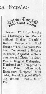

The plain AT&Co
ATCo

The one on the left is 1897,. and on the right is 1901, they both have the same damaskeening as do about 7 more ATCo's in my "bunch", and they all advertise as "P" grade. So what I need to know is how do we determine the "Premier" from the "rabble"?

You can't see it in the ad that Tom posted about the Premier, but I found a larger version of the same ad and Premier is actually engraved on the barrel plate.
February 25, 2009, 00:04
From searching images on the web it would appear the Premier grades have that engraved on the movement.
premier

Thanks, Tom, Mary-Ann,& Dave.I see that the only apparent difference is the 5 position adjustment on the "Premier".Mine is The standard model, it also has the same damaskeening pattern as the ones you show.They, like all 1892's , are a beautiful movement.
