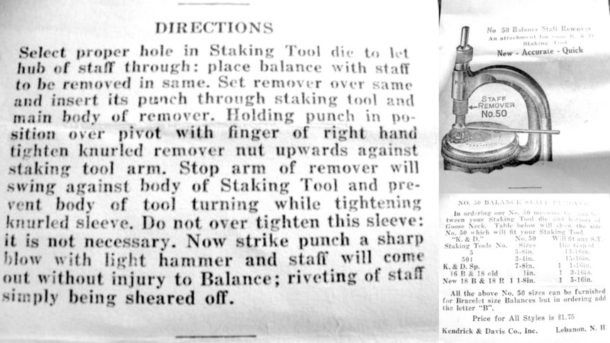

We all agree that the best way to remove a staff is with the least damage to the balance wheel.
I totally agree that with a razor-sharp graving tool, a Watch Maker's lathe in class A condition good eyesight and knowledge of where to make the hand-held cut, the staff can be cleanly de-riveted.
Experience and good tools will do the job. I marvel at the slick little ring the #50 staff removing tool. By following the instructions (below) it will shear off the old balance staff cleanly at the rivet hub face.
I often see a deep chamfer left in the cross arm of a wheel that has had the old staff machined out. that is why I prefer the #50 because it will not remove any of the surface around the staff mounting hole which makes re-riveting a new staff in place much easier.
I did a pictorial on this at:
Balance Staff Removal Instructions

Dave is correct in his statement that we all agree the best way to remove a staff is with the least damage to the balance wheel.
If someone cuts the staff out on a lathe and leaves a chamfer, then there is damage to the balance. Properly done, there should be no damage to the balance when cut out on the lathe. On the other hand, there is ALWAYS damage to some degree when the staff removing tool is used. You simply can't sheer a rivet thru a hole without doing some kind of damage, even if it is minimal. The second, third, etc. time exacerbates the problem. I have personally never seen the chamfer condition, but I have seen MANY oversize holes after cutting out a staff. The only logical conclusion I can draw is that previous staffs were driven out and the hole enlarged. When I try numerous staffs and they are all loose in the hole, what other explanation is there?
So...did someone invent a tool that does the job? Sure they did and the first time it might not cause too much damage. The second and subsequent replacements do more and more damage so tell me why we would want to use this method today when we are not in a production environment where time is money? Would I save a few minutes on a staff job using the tool? Maybe, but I will NEVER compromise what I feel is a correct methodology for the sake of saving time.
BTW, I have an Elgin service bulletin that shows enlarged microscopic pictures of hole damage when a staff has been driven out.
