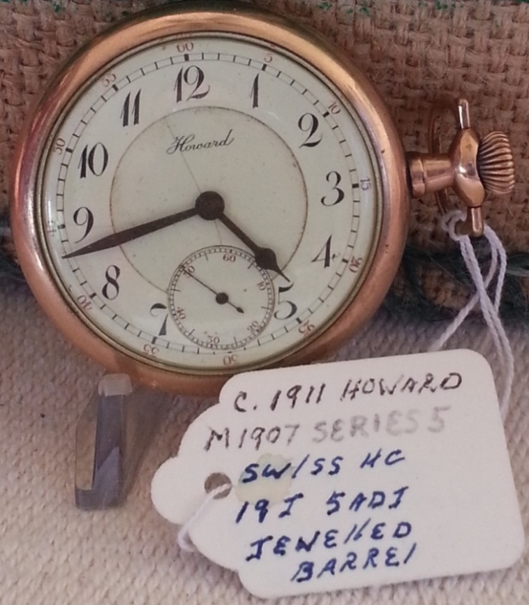

Paul D. Trombley
My far from original circa 1911 model 1907... it is frustrating that the book lists a 23J jeweled motor barrel, but does not list a 19J jeweled motor barrel.
I picked up a very nice Keystone Hunter Case to swap this in to, have acquired three different sets of hands, umbrella, open diamond and thin spade, but have not decided which ones to put on when I do the COA.
I have yet to see a Keystone Howard Hunter case come available.

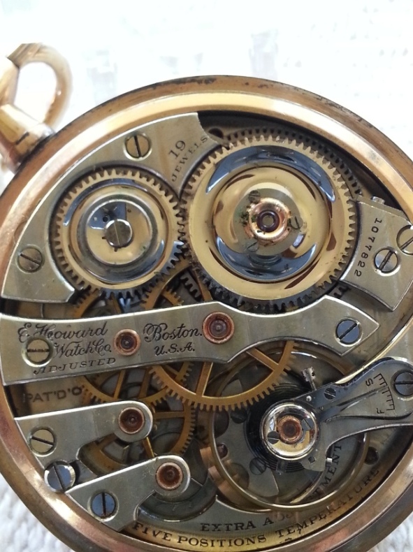

Paul D. Trombley
And the movement...

Paul D. Trombley
Ken,
Don't use my watch as an example for validation. When I bought the watch, I was all about the jeweled barrel and negotiating my price for the movement.
It wasn't until I got home that I began to question the hands and not until I did some photos and saw the watch larger than life that I noticed the dial has been apart and soldered back together out of alignment.
