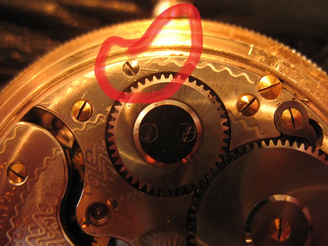

I have this 975 and cannot seem to be able to remove it from the case. My question regards the screw I have circled. I assume this is a detent screw to hold the stem but do not know if it should be removed entirely, or just loosened. I tried loosening it a bit but still cannot seem to get the stem to release from the movement.

It should only be able to be loosened. The early detent unfinished hamilton plates I have do not allow the screw to be fully unscrewed. I'm assuming you would have to split the plates to remove it fully.

I would try loosening it a little more maybe a 1/4 turn at a time until the stem can be pulled out..The screw will not come out unless that plate is off the watch..Worse thing that could happen is the detent screw will come out of the set lever(i think that is what it is called) and you would have to take the dial off the watch to reattach it ..Good Luck.

I think that is a cap screw and has to be removed
to get at the detent screw.

Mike try this; I just checked my movement that is not in a case hand has no winding stem. If you turn that screw counter clockwise it moves the lever toward the top of the opening away from the winding stem. If you turn the screw clockwise it runs the lever in so the the lever is locked into the notch in the winding stem. The screw will not come out with the plate on. My guess is if you turn the screw in the further most counter clockwise position you may be able to left the winding stem out and free the movement from the case. You may need to rotate the stem that I am not sure of. That is what it looks like to me.

Mike, back the stud out as far as it will go (counter clock wise.) It will not come out of the pillar plate. keep the watch dial side / pillar plate up. The stem should come out when pulled and maybe wiggled easly.

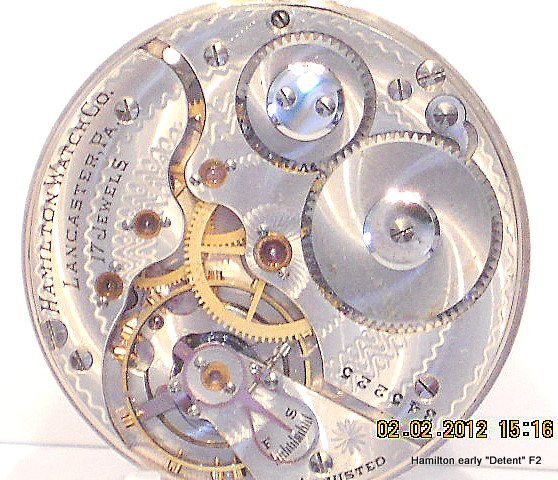

On the early Hamilton "detent" type stems, there is a "plate" screw as in your picture. Once removed there will be another screw down in the recess that needs to be counter screwed enough to allow the stem to be extracted. The second screw is attached to the "stem-block" that keeps the stem in place and when counter screwed this "stem-block" moves upward and away from the stem, allowing for stem removal.
I have 2 pictures;
Picture#1 [Plate screw Removed]

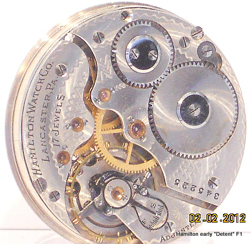

Picture#2; [Access the "stem-block" screw & counter-clockwise enough to remove stem]

My movement I pictured has NO arrow on the movement, the same as Mike's. Usually if you have an arrow engraved on the movement, then turning it in the arrows direction will back the "stem-block" away from the stem allowing it to be removed.
My movement is missing the plate screw, but the "stem-block" screw is down in the recess as pictured. My movement which is a 975 also, has threads for a plate screw to hide the "stem-block" screw. On Mike's it appears the screw we are looking at fits flush with the top of the plate. Now the ones with an "arrow" engraved on the pillar plate, generally fit flush and I don't believe they have a plate screw. I am of the opinion that we are looking at a "cap" screw on Mike's movement that once removed counter clockwise, we will find the "stem-block" screw further down into the recess.

Well, Buster was correct. i took out the cap screw, loosened the screw under that, tuned the watch face down, and out came the stem, and then the movement. Worked like a charm. Thanks to all. Buster, i take back all that stuff I said about you Smile Roll Eyes Eek
