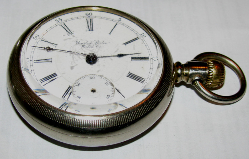

Can any Waltham experts tell me what I've got here please?
Just bought via eBay, and done a quick search of the Waltham database and the details don't add up.
According to the DB, it's an 18S Wm Ellery, Key wind, with 7J 3/4 plate movement dated around 1863.
It's actually a Stem Wind, Lever set movement, with screw set jewels all the way to the centre wheel, a cut bi-metalic compensation balance with timing screws and a micrometer regulator!
I've not had the dial off yet to check the jewelling on the dial plate.
All it states on the movement is 'United States Watch co', 'Waltham Mass', serial No '95461'

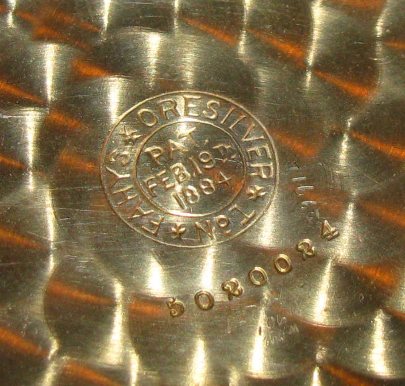

The case has a screw back and bezel, and stamped 'Fahys * Oresilver * No1' Serial No 5020024 - all case numbers match.
The movement screw marks are a tad out of allignment on the case, yet the movement and lever fits like a glove.
It's a non runner, fully wound and with a sticky balance, but the staff seems sound enough.
I didn't even know it was a Waltham until it arrived and got the back off, (cringe) the auction listing just stated 'United States Watch Co' ........ Shows what I know about these watches!
The auction photo's were also pretty poor, but I could still make out the beautiful damascening and all the screw set jewels, and had a hunch it might be a tad out of the ordinary, but maybe not?.

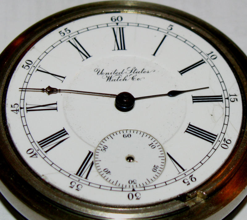

The hands don't appear to match, can anyone tell me which one is the correct type? I suspect it's the minute hand.

Dial.
Some damage which I suspect is over a dial foot, plus some hairlines.

Case Marks.
John

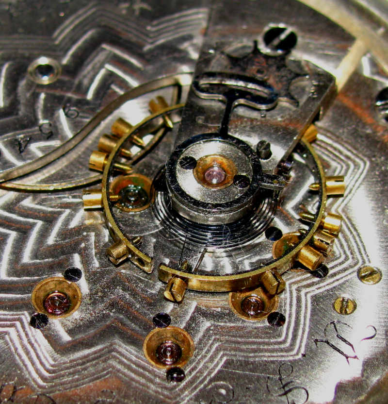

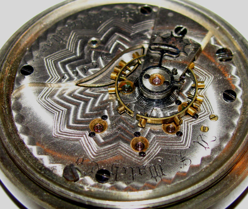

Balance and jewels.
There's quite a few marks on the plates, which look like black rust spots, maybe from finger marks.
Is there any way of getting this off without spoiling the damscening?
John

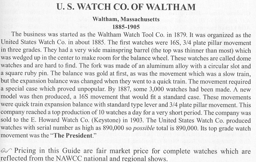

You have a very nice Hunter Movement of the U.S.Watch of Waltham (USWofW) brand.
The USWofW was formed with the combination of some financiers and Mr Van De Woerd, the Waltham Genius who left American Watch Co, Waltham in the late 1870's and formed his own Watch-making Machine Company in Waltham.
The below is excerpted from the 2008 price guide about The U.S.Watch of Waltham Company.

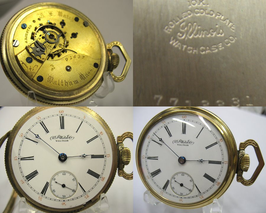

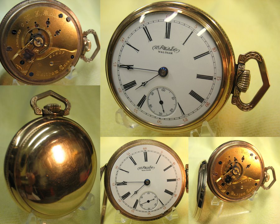

They reflect the early genius of Mr. Van De Woerd's design and machine work that started under the influence of Dennisen. This one looks great even with the wrong hands. (they will be replaced when I clean and service this)

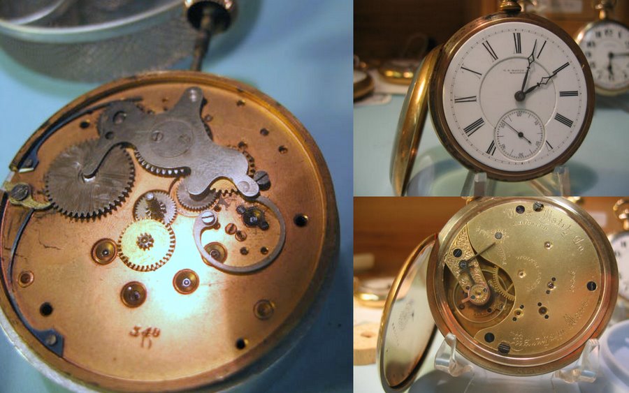

This first generation S/N 348, 18 size USWofW tells the whole story of the firat Waltham 3/4 plate 10s and up designs by Mr. Van De Woerd. Most interesting wind and set mechanism too!

Thanks Dave, is it worth hanging on to, or an interesting clean up excercise to move on?
I'd a suspicion it was a recase due to the odd screw marks.
Looks quite nice in this open face case though, and quite a chunk to hold.

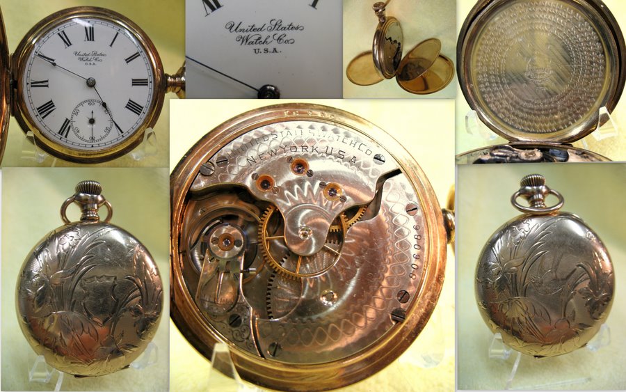

John, a serial number 95461 of anything is collectible, and this is a fine 1892 vintage example of the early phase of that company. Please keep it or let me know first if you decide otherwise. I developed a taste for these as I learned more of their short history. Below is my "last" model which a very finely done Hunter Case that in the haste to attract buyers was marked New York where in fact they had some interested investors.
This one happened within Months of the Keystone Buyout. Looks like the beginings of a Keystone/Howard movement doesn't it?

To get back to your watch, it appears to be a nice looking watch, I have found that a lot of times those rust spots will just come off in the cleaning. I think sometimes it is actually crud that has gotten on the plates & rusted & not the plates themselves.

Fine looking watches Dave, I especially like that art nouveau case engraving - or is it repousé work?

The minute hand seems 'right' for the watch somehow, and think I've got a couple of pairs of this style anyway, so will have a play around and see what fits.
You're probably right about the spots, they're miniscule specs as if a fine mist of water's clipped it.
Not really visible until you get it under a loupe, just don't want to damage the damascening trying to get it off.

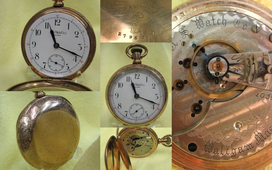

John this "cousin" of your movement popped up when your thread caused me to look for an hour hand. As our presidential Inauguration is now completed, I think I will re-direct my "re-energized" spirit to rehabilitate this little beauty. Thank You for making me look! Smile

Hey David, that is One Nice Watch!
So close on the serials too, I wonder how many others are still out there?
Have to say, if that watch of yours is ready for 'rehabilitation', it makes mine nearer ready for the bin Eek .......... Only kiddin' Wink
I don't know how you guys find stuff like that.
I feel better about the hunter setting in an open face case now, having seen yours.
I always imagine hunters having a front dome for some reason.
Maybe I've looked at too much European stuff for too long ............. Roll Eyes

John, as pretty as it looked it smelled like a rendering factory. I have it out of the cleaner now and will add pics when it's done. I like yours especially because it is an early Nickel Damaskeened plate movement and I think it will clean up beautifully, but it does need a morning glory hour hand to compliment that nice minute hand.
Now it does not smell like a dungeon. The "Depression re-case" even looks good.

Beautiful result David, I would love some more time to be able to really dig into my stuff and get them up on the boards.
