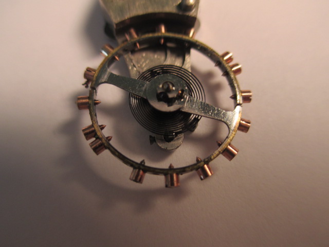

Smells like someone dunked the movement in breakfree or some other nasty stuff.  Oh it is really bad - you can see it oozing out the plate screws.  Even with the oil dripping off the hairspring still had decent motion at the balance wheel, but the pallet fork was not moving.
Here is a picture - what could ever be wrong
December 07, 2013, 13:05
David AbbeThe roller wheel and jewel appear to have indexed away from the corresponding notch on the safety roller which prevents proper cycling of the pallet fork. The result, the fork will not cycle at all, instead it will appear to be "overbanked". Because of the general description of this watch, it should be completely disassembled, cleaned, inspected and the balance assembly properly adjusted and poised.
December 07, 2013, 13:18
Joe StraubI'm not a watch repair person . . . but it looks like the safety roller notch is not centered over the impulse jewel.

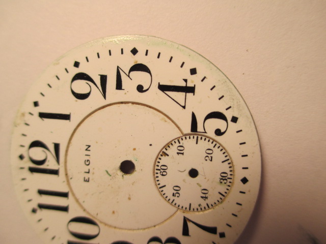

Jon HartYou can see the oil film sitting on the edge of the dial
December 07, 2013, 13:31
Jon HartAnd some puddles of the smelly green stuff - LoL

Some soft scrub and old tooth brush have the old dial at the position of attention
December 07, 2013, 14:25
Joe StraubWhew . . . nice!  I noticed the dial was in good condition.

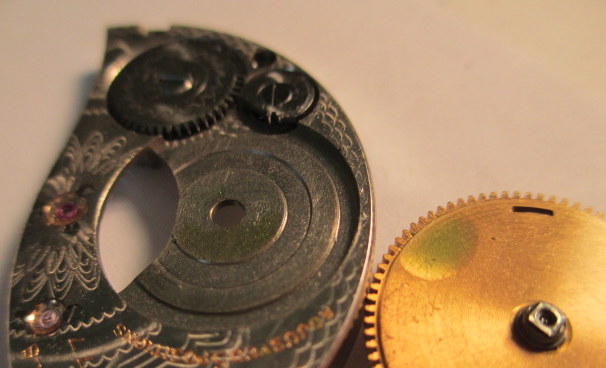

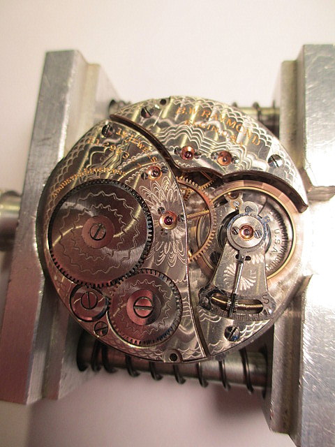

Jon HartDave - surely needed a complete tear down and clean.   Got lucky on the balance wheel, though, was not bent and the roller table was just free and spinning between the bottom of the hub and the safety roller.  I guess the good thing about the previous green oil bath there surely was no rust
Off and running, again...
December 07, 2013, 21:34
David AbbeIs that a 19J Grade 455? Beautifully done. Excellent condition, the green goo may have preserved it. Good Save!!!
