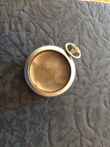

The case is, or should I say, was Silverode, badly worn and scratched. The question here is, do I leave the case as is, or should I have it replated. I know many times with antiques, refinishing is a no no, but I'm not sure what the rule is for pocket watches. What should I do?
November 28, 2013, 12:47
Robert Letourneau
What do you think?
November 28, 2013, 12:49
Robert Letourneau
Second photo
November 28, 2013, 12:50
Robert Letourneau
November 28, 2013, 13:17
Robert, no need to plate "Silverode" an alloy containing 1% magnesium, 54% copper and 45% nickel which just plain polishes out "real shiny". I usually lightly buff these out with buffing compound and then polish on a second wheel loaded with rouge.
November 28, 2013, 13:27
Robert Letourneau
David, that's great news. Will be shipping the case to Peter tomorrow. A long ride from Massachusetts to Arizona Big Grin

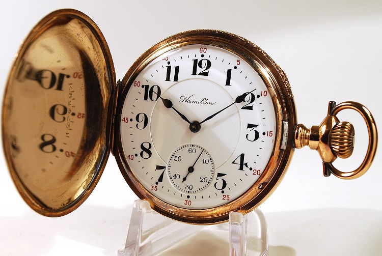

Like you, I stumbled across this bunch years ago while trying to piece together my father's watch. Whatever the market value of your watch, I'm glad you're restoring it simply because it's an heirloom.
My dad's Hamilton 993, the very watch that started me on this hobby:
December 04, 2013, 09:00
Eric Unselt
And also like you, I wondered if I should leave my dad's watch in the clunker case that it was in, or find an appropriate improvement. I chose to upgrade to something a little better:

Peter Kaszubski
Agree and disagree
agree on gold filled case if is all worn out
but on silveroid case buffing and you good to go
here is Roberts case after I fixed it for him.
Bow is tight new acrylic glass and new crown
and few minutes on buffing wheel tada!

Peter, thank you so much for helping me with my watch. I literally had a smile from ear to ear, when I saw the photos. Incidentally, I mailed the case to Arizona on Saturday, USPS Priority, you received it Tuesday (yesterday). It is on it's way back to Massachusetts today (Wednesday). I'm not sure when you worked on it, but that's a quick turnaround, besides covering a lot of country. Peter, you've made a new friend. Thanks again

Eric, thank you for your kind words of encouragement. Your Dad's Hamilton is absolute eye candy. I have to agree with your idea of upgrading the case. It really does do it justice. A family treasure for generations to come. I appreciate your input. Thanks
