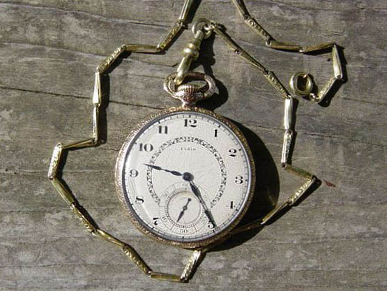

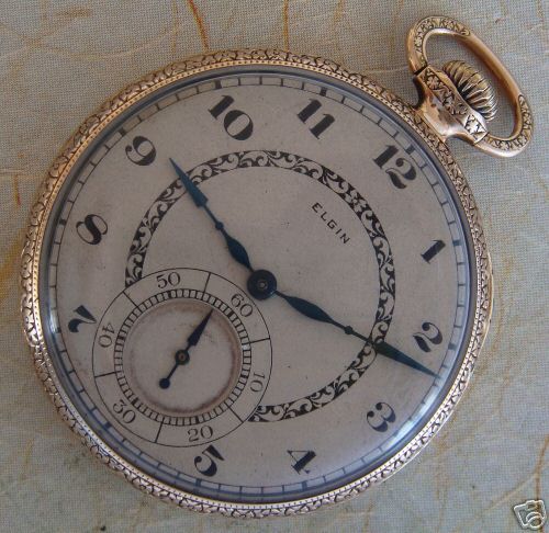

I just recently purchased a 1920 or 1923? Elgin pocket watch at a very reasonable price(I think). I know very little about the information I obtained from the seller being that I am new to the watch/clock world. But I do know I am "hooked" or sorta obsessed with time pieces, I think more so on Pocket Watches rather than clocks. This one just sorta struck my fancy. I would appreciate some thoughts here on this particular piece... I do know that there are some expert professional collectors on this forum that know their "stuff" and I value their opinions. Here is the description and I will post pics:
MOVEMENT:ELGIN NAT'L WATCH CO,SERIAL # 23,622,499,GRADE 384,SIZE 12,CLASS 114,OPEN FACED,QUICK TRAIN,PENDANT WINDING AND SETTING, 3/4 NICKEL PLATE,3rd MODEL,SEVENTEEN JEWELS, GOLD JEWEL SETTINGS,EXPOSED WINDING WHEELS, ADJUSTEDTO HEAT,COLD,AND ISOCHRONISM,STREAM LINE BOW AND PENDANT. MOVEMENT DATES TO 1920, CUSTOM MADE FOR OTTO YOUNG & CO.,wHO GAVE THE MOVEMENT, AND THE WHOLE WATCH, DISTINCT STRTEAMLINE FEATURES FOR MARKETING IN 1923......ACCURATE. HAS BEEN STORED BY A WELL LOVED RECIPIENT FOR ALMOST ALL OF IT'S 85 YEARS !! VERY LOW MILEAGE...THESE 1923 OTTO YOUNG AND CO STREAMLINE WATCHES, ARE SINGLED OUT BY ROY EHRHARD IN HIS BOOK ON THE ELGIN WATCH COMPANY.
DIAL: DESCRIBED BY THE MANUFACTURER AS "CLEAR, SPACIOUS, SILVERED".ORIGINAL.
HANDS: BLUE/BLACK GUNMETAL. CROSS BAR DIAMOND STYLE.
CRYSTAL: GLASS. ORIGINAL
CASE: 10 KARAT GOLD FILLED BY THE WADSWORTH WATCH CASE CO OF NEWPORT, KY. SNAP ON FRONT BEZEL WITH HINGED REAR COVER. BEAUTIFULLY ENGINEERED, HAVING AN ENGRAVED BOW, WITH ENRAVING SURROUNDING THE BEZEL AND ALSO SURROUNDING THE SIMPLY PLAIN REAR COVER.
pics to follow
April 15, 2008, 13:04
Stevan Tiffin
Elgin pic:

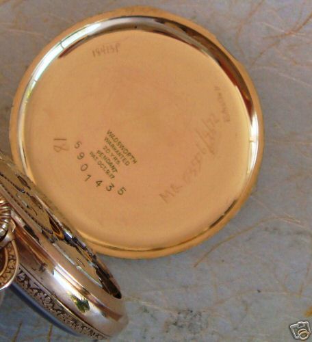

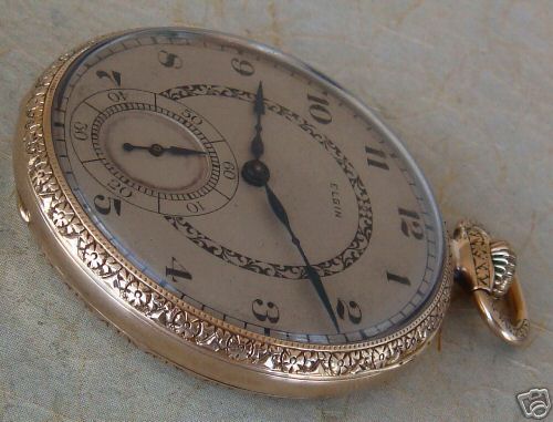

another view:

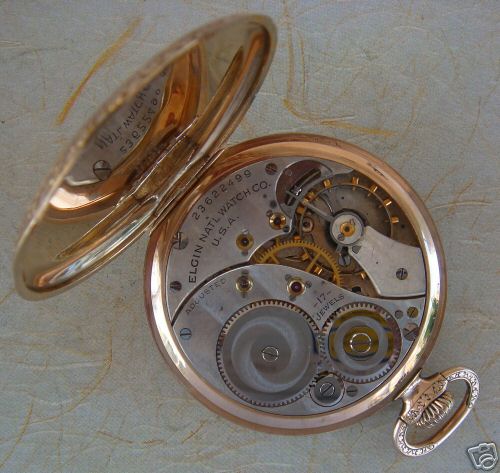

movement:

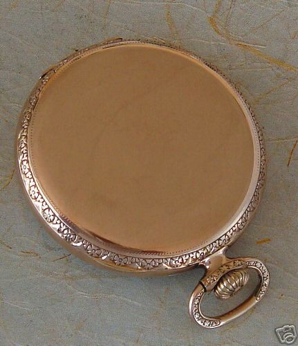

inside case:
April 15, 2008, 13:09
Stevan Tiffin
another:

What I like about your watch is that it is all original. A few clues are that the hands all match, the engraving on the bow matches the bezel, and there is only one set of case screws. The advertising that David found just confirms this. Due to the various sizes of 12 size movements (diameter and thickness), cases and dials were not interchangeable Thus, 12 size watches are fairly easy to find in original condition.

Congratulations Stevan! You reunited the chain to the watch! As for winding the watch, don't be afraid to wind it up until you feel some resistance to the wind. It should run about 30 hours on a "full wind".

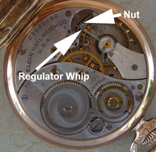

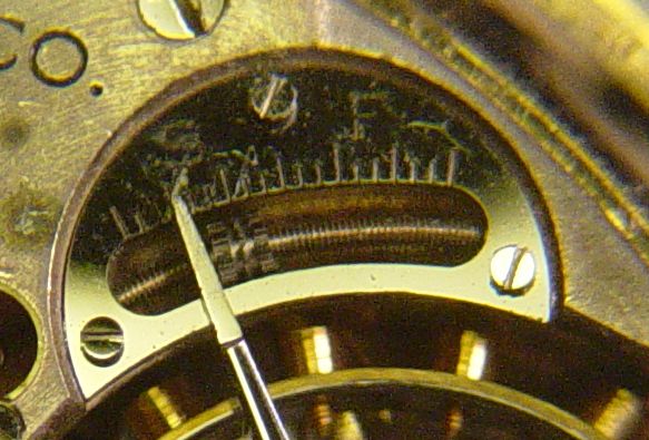

I noticed in the first pictures you showed of the movement that the regulator whip has jumped out of the regulator micrometer nut. That may indicate someone tried to adjust the timing and that the watch needs cleaning as when it "dries out" it will often change speed more than the regulator can handle.
My suggestion would be to have it cleaned, oiled and recalibrated. Then it should be good for a long run with it's "new keeper".

I took a close up of the area you indicated a problem:
April 20, 2008, 23:22
Stevan Tiffin
I will do as you suggested. Also when I took this pic a few minutes ago, enlarged it and cropped it, I picked the watch up and moved it around and it did stop. I turned it and it started back up and it running now as it has all day. Will the problem you indicated cause this problem?
Thank You,
Stevan
April 21, 2008, 00:07
Stevan, if it stops, then I would recommend a cleaning, as if things are too "dry" the watch should not be run much until it has been given an "oil change".

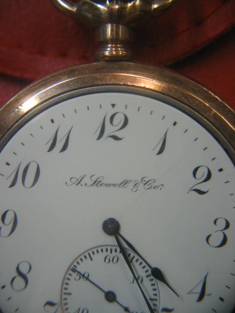

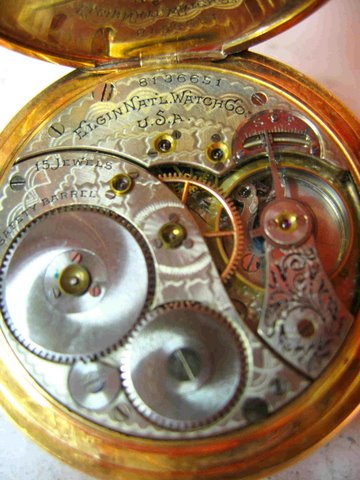

Thomas, This is the ONLY watch I have with Brass Bushings factory installed into Center Wheel and Motor-Barrel screw-in Jewel Mountings. I raised this observation in a thread last November and speculated that the "Jeweled Look" might have been more desirable than the added cost of 4 more Jewels as this watch was made when many expensive swiss Jewels were still being imported.
One reply to that old thread was that as this watch is a very high level Jeweler's Private Label; "A Stowell and Co." it just stands to reason that it had to be a high quality movement. Puzzling, as a 19 Jewel 12 size at that time would be definitely high quality, and a 15 Jewel marked movement that could have been a 19 is sort of nouveau-stupid to me.

Thanks for your reply with that information. It prompted me to pull out my 15j Elgin movement like your. I've never looked to closely at it since I obtained it as a parts movement. It has the brass bushings like yours, which is interesting. What's even more interesting is that the center wheel looks not to be of brass but gold! I find that kind of strange. Is yours like that?
