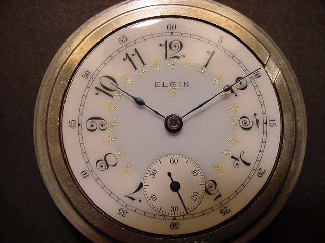

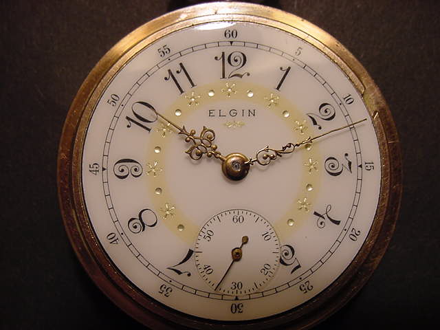

May 11, 2005, 20:04
Tom HuberHere's a pic of one of my fancy dial Elgins.
