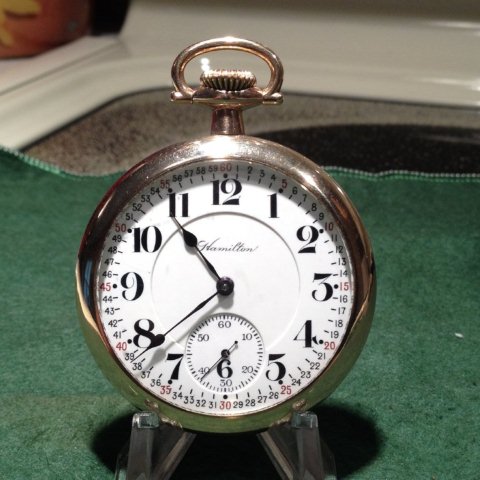

Hi,

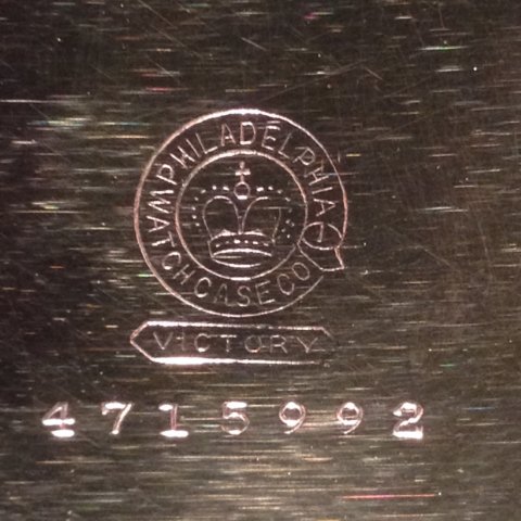

I recently picked up a really nice 1913-1914 Hamilton 992 model 1 movement (serial# 1057978) that is cased in a like new Philadelphia Watch Case Co.(Victory) case. I am concerned that the case is too much like new, I do not know if watch cases have reproductions but this one looks too new.
I know from doing a little research that the "Victory" case is a lower grade case with a 10 year wear thru and that should be stamped on inside back cover. This case has only name and serial# with no year wear thru stamped. I have several of the Philadelphia cases and all have the year (Wear-Thru) stamped inside.
I still have several days to return this watch and would very much appreciate some expert opinions. I will post a couple pics below.

Front

Donnie, with that Montgomery dial, who needs a case?
If the case marks are only from this movement, then I suspect the watch was re-cased which is a legitimate action and the lower cost cases were often reflective of the more experienced but less rich married with Kids Railroad Person.
That at least could be an explanation of the Victory case which was made about the time of WWI and later, making it's legitimate use as a re-case logical.
Seriously, look at what you paid for the watch and make your own decision, but I expect there are a lot of members who would be happy to "dicker" with you if you want to get your money back.

Donnie,
In gold-filled cases sold after 1924, wear-through guarantees were prohibited (see Shugart Watch Guide, page 36), so not to worry, the lack of a guarantee doesn't mean anything bad. That just means it's a post-1924 case.

Donnie, That case style with the French bow and longer pendant, even though "newer" than the movement,looks great with that dial and fancy damaskeen pattern movement,a railroad watch like that may have worn out a case or two in its working life, that's for sure.Those Victory cases are a nice well made case,and it looks right for the age of the movement.(just my opinion).Regards, Ted.

Sweet, Donnie!!! It's a keeper IMHO.

Donnie, that is one beautiful watch!
It is also a "two screw" 1st model, and I have not looked as everything on my watches is packed right now, but it just may be the last year that they made the 1st model 992. They made a LOT less of the 1st model 992s than the 2nd model 992 that was made from 1915 to 1940 when they came out with the 992B.
You paid less than I get for them on eBay Donnie. I have got as high as $1151.00 for one in a swing out case, and average $450.00 to $600.00 for them all the time.
In my opinion, for what it's worth, you got a GREAT deal on this one.
