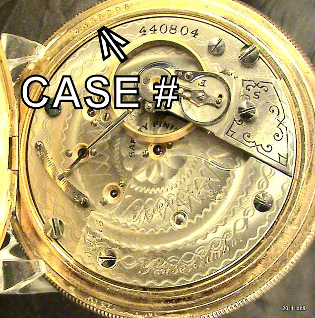

October 29, 2011, 12:01
The numbers on the frame are usually stamped on the back side rim face, and the crystal bezel often has a few last series digits in Roman numerals hand scratched into the inside perimeter.
