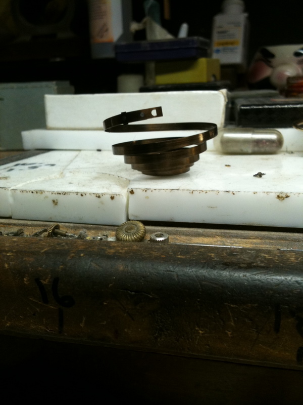

Eugene BuffardThe wrong way to install a mainspring.
Some one put this mainspring in a watch I bought by hand. They did not use a mainspring winding tool. The watch was running 40 minutes slow. Only in some positions. Which I believe Dave Abbey mention that it would effect.
Dave Abbey will love this photo.

Cecil McGeeHey Eugene, Looks like a little more than just a "hand" installed problem. I have a mainspring winder,but I find it is more trouble to use that it is worth. I have been installing my mainsprings by hand for many years,and have yet to get that effect. That really looks more like it might have been done by stretching it while removing it at some time in the past. Either way it has certainly been subject to some serious abuse. My jeweler friend is a third generation watch repairman,and he also told me that he hand winds his mainsprings.

Eugene BuffardYou could be correct all I know is this is one messed up mainspring.

Dan CarterIt looks pretty tightly coiled too, and therefore probably has no energy left. It looks like it is a piece of "steampunk" jewelry

Buster BeckI don't know nothing about this and I have never pulled/changed a mainspring, however
I am not shy
That M/S pictured looks to me like it is what I would expect a M/S to look like,
That has taken a "set" over a period of time and needs to be changed. It will never impart it's full power to the train since it has metal fatique.
Whether one hand winds or uses a winder has no bearing on when or whether a M/S will need replacing, I think

Eugene BuffardIt does look like a mainspring is suppose to look except that it is heli coiled. and also set.

Dan CarterYes, It should be flatter (not cupped) and spread out more. This mainspring would rub / scrape against the upper or lower portion of the barrel losing energy from friction if installed anywhere, and due to its "memory" it would have very little energy left anyway. This is usually the second thing I suspect when checking a watch that is running too slow, the first is gummed up jewels, the second is a spent mainspring.
