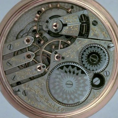

Steven Ford
Like this? Smile
One of my favorites, but I guess we are way off the subject!

Harry J. Hyaduck Sr.
Yes Steve eye candy. I like the Elgin 3 finger bridges and although I have several with black script I do not have any with the gold script like yours. Nice. I don't know much about these Elgins but I notice the pattern on the wheels are different. Are they suppose to be different?
Harry

Steven Ford
Harry,
I have several Lace Doilies ,and they all have that same pattern on the winding wheels. As far as I've seen they are all the same.
Steve
