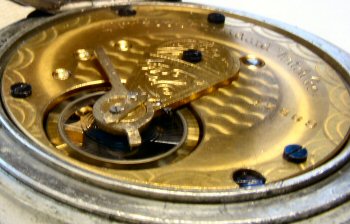

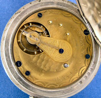

Does anyone notice anything unusal about this 18Size New York Standard? The seller assured me that the watch had just been repaired by a watch expert.

Ed UeberallI appears to me that the "repair expert" screwed a small brass plate over the balance cap jewel, probably to keep a loose jewel from falling out.

Wayne C. AndersonEd,
Did you look at the regulator? It appears to be a crude replacement.

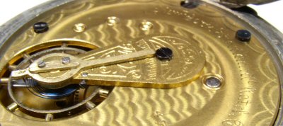

John PavlikThe brass "regulator retainer" appears to hold the "custom"
regulator to the balance cock....

Ed UeberallI think you are correct. The NYS watchh cuts shown on p.47 in Roy Ehrhardt's ID & Price Guide #2 show the index pins on the regulator arm to be at a 90 deg angle to the index arm. The "replacement" has the index pins located 180 deg from the index arm.
If the hairspring hasn't been modified, this example should run fast with the index arm in the middle of the scale.

Wayne C. AndersonThe repair expert certainly went to a lot of effort to fabricate an regulator for a New York Standard, even if the arm is slightly too long and will not pass by the screw. This has to be a great example of a "do-it-yourself" repair, and if a replacement part was not available, it did get the watch running. But it does not keep very good time.
You are correct on the position of the regulator - a few drops of oil, moving the regulator to a usable position, a few winds of the stem, and "its running". Fun morning when its too cold to go outside.
