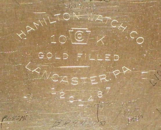

THe Case A would have to be shouldered and have a very low case number (see photo) to make it credible.
1940 Hamilton Case A Signature

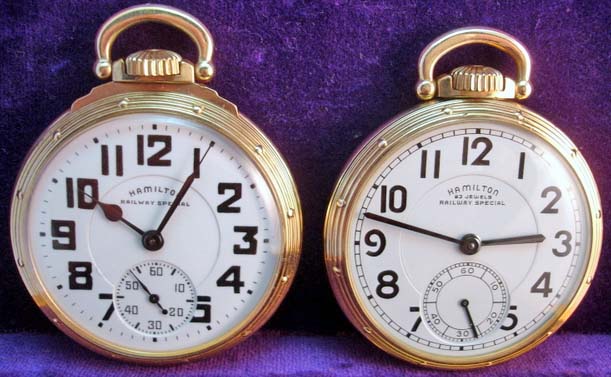

Your Case A would need pendant shoulders (see photo) to have any credibility on a last run 9902E. To be considered strictly correct for 1940, the case number would have to be all numbers, with the first 3 digits 120 thru 124. The K prefix started later.
Case A w/ Shoulders (1940-1948) on the left -- w/o shoulders (1949-1954) on the right
