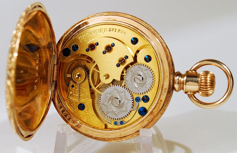

Eric UnseltIt wasn't running. There was a burr on the lower balance pivot that was binding it up, and the mainspring was blown.
I successfully got both the roller table and the hairspring off (thanks, Roger
), chucked it into the lathe, and honed the burr out. The movement was cleaned and oiled, a new main was installed, and several screws were blued.

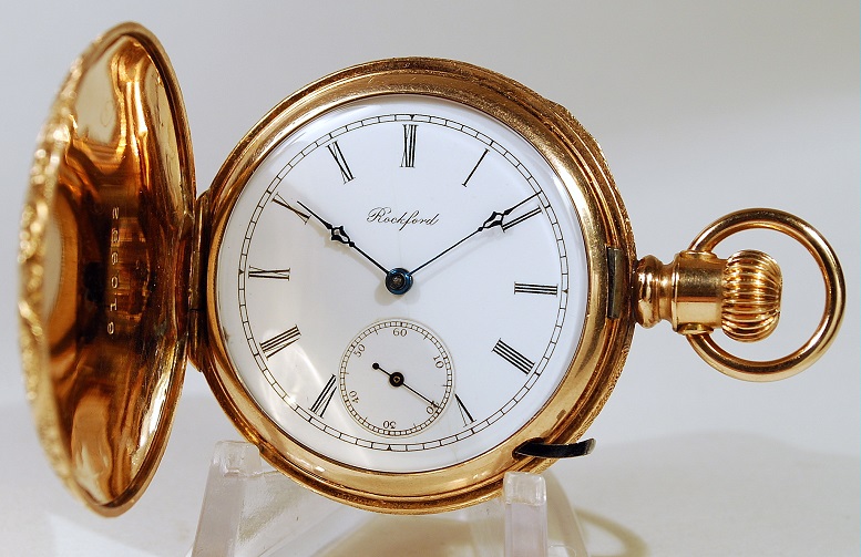

A 6s 15-jewel gilt Model 2 Rockford - running, and keeping time:
September 07, 2013, 20:57
Eric UnseltA better dial, a new crystal (thanks, Peter
), and all three hands were sanded, polished, and re-blued.
September 07, 2013, 20:58
Eric UnseltAnd the caseback.
I told her the center stone was a diamond. I'm fairly sure she believed me.

Gary E. CochranPretty little watch..looks like it was never used..
September 07, 2013, 21:52
Roger J. NolfeVery nice Eric! Great job fixing it up. She's going to love it.
September 07, 2013, 23:38
Doug ScheurichGreat Looking watch.. very nice job on the bluing.
September 08, 2013, 10:30
Donald NicolaiNice job Eric
Don
