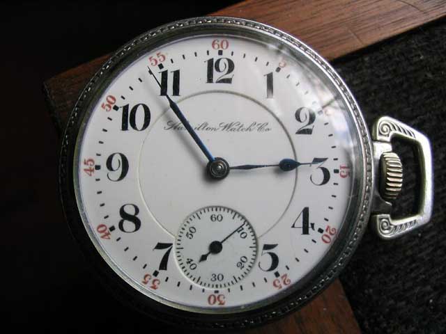

May 03, 2004, 17:40
Jim,
Rob and Kenny called it well... There are a few choices and variations in Hamilton hands around the turn-of-the-century era in which your 941 number 89042 was produced.
If you retain the hour hand you may want to replace the bold minute and second hands. In the image below I set two watches to the same time as yours in order to help illustrate the point. Your 941 is a great watch, I'd want to find a nice hunter case or in the alternative a marked Hamilton display case such as you see below.
Below, representative correct for around 1900 Hamilton hands...
