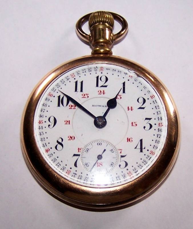

Here is a photo of the movement before the repairs.
September 12, 2010, 22:56
Gary Dutton
Here it is running and in a better case.
September 12, 2010, 23:00
Gary Dutton
And here is the cleaned and oiled movement.
One of the prettiest movements I.M.H.O.
September 12, 2010, 23:01
Gary Dutton
I have had this running now for about a week and it has kept fantastic time. This is going to be a keeper.

Nice job Gary!
I have always liked those Howard dials with the minute markers turned that direction. I would make it a keeper too!
