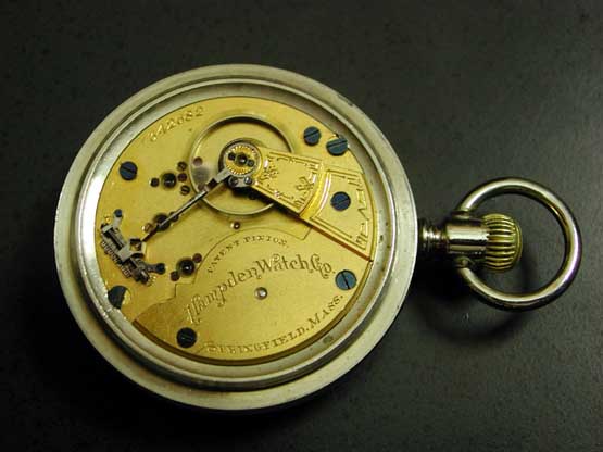

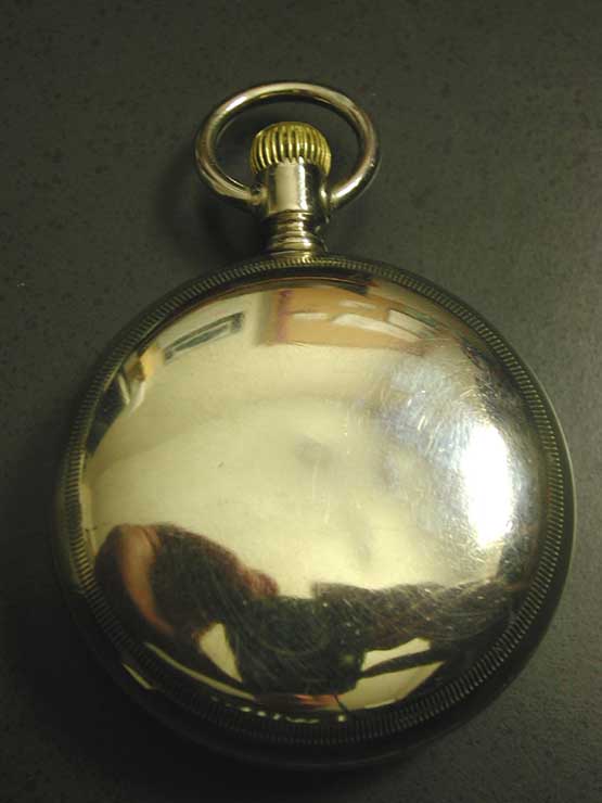

Well I've switched bits and here's the finished pocket watch. Unfortunately I wasn't able to use the Dueber case as the winding stem wasn't long enough to be able to wind the movement. So I've used a Fahys Oresilver case with a thick crystal with a patent date of 1884, so that should work with a movement from 1886. What do you think?
Thank you, Roland.
R. Glenn
February 22, 2010, 10:29
Roland Glenn
Heres the movement in this case. The screws line up very close to previous Illinois that was in this case.
R. Glenn

Has a smooth back.
R. Glenn

February 22, 2010, 20:41
Theodore J. Brown Sr.
Looking good, Roland...Those gilt movements do look better in silvroid/silver cases!...Ted.
